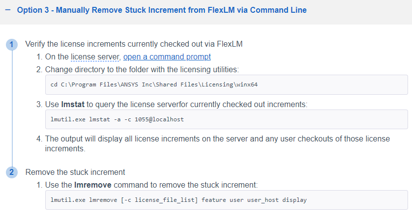

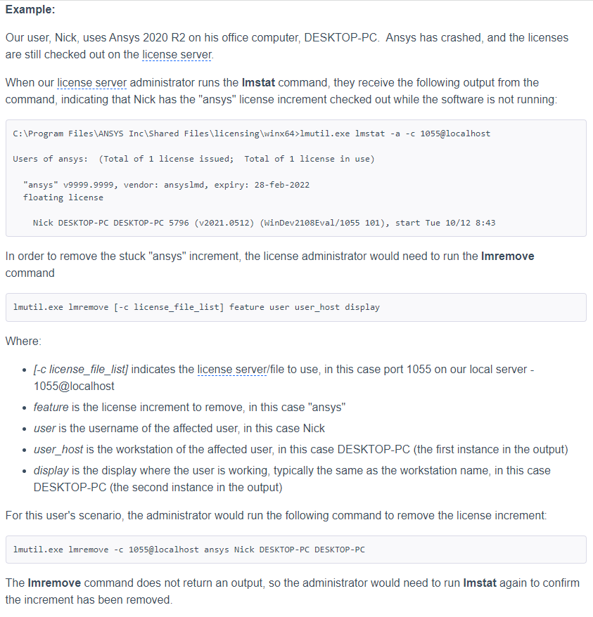

Remedy/workaround:
https://install.simutechgroup.com/how-to-release-a-stuck-license
I was able to apply this successfully and write it into a BAT.
This BAT needs to be run as admin & the respective Ansys application restarted.
It's a little tedious, but better than clicking away dozens of timeout warnings for 60 minutes and then stopping work for 60 minutes.
But fortunately, a VPN interruption (hopefully) is relatively rare anyway - at least a workaround is now known.
Anyway, this FLEXlm feature is very bad compared to CATIA handles it.

Ansys EmployeeI apologize for the delay in response, but you are correct as it is a limitation using VPN, and removing stuck licenses..
Good to hear you are able to use the bat to run lmremove.
