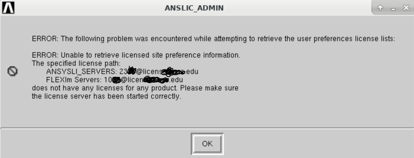

    • heechangna
      Hi George,
      When I try to open the License Preferences on the Tools tab, I got:
      Any comment would be very helpful! Thanks!
      -Heechang
    • George Karnos
      Emailed for License Server Diagnostics
