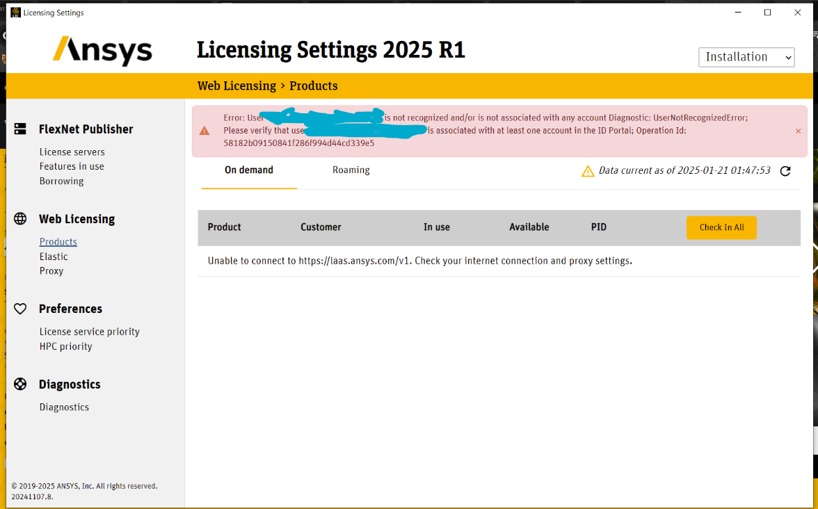

I'm having issues installing Ansys.ÂI have the Ansys License Manager running successfully. On there I have this: Products licensed in this file: # 1. Ansys Academic Research Mechanical and CFD (1 task): 1 task(s) Lease expiring 30-Jan-2025.ÂI can't seem to find how to actually get the license activated/working for the ansys workbench. There I just get this:
ÂPlease let me know what I should be doing from here.ÂThanks,Jeffrey -

Ansys EmployeeClick on License Servers under Flexnet Publisher
Verify that this is enabled and the port and hostname of the license server is correct.
This should allow you to check out licenses.
