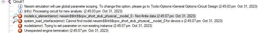

I have a fairly simple simulation of a CPW transmision line with a hanging CPW quarterwave resonator. I find that if I use certain built in components the simulation runs into errors

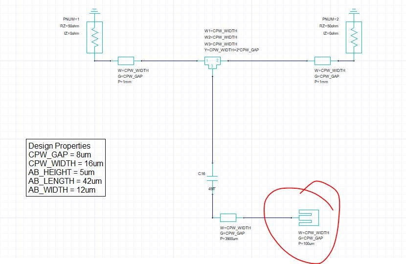

If I run a simulation where the hanging resonator is terminated by a CPW short stub then I cannot run and receive an error.

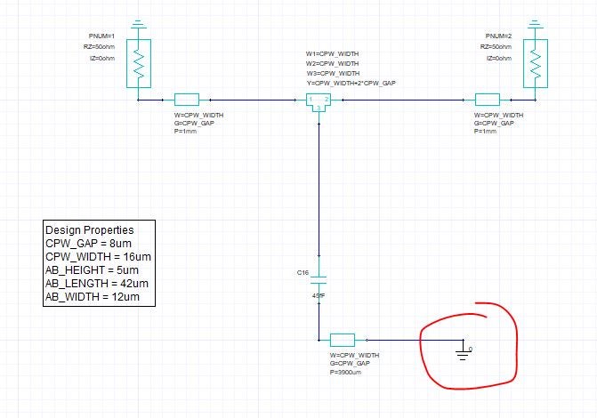

Replacing the stub with a grounded pin allows the simulation to run
What exactly is this error referencing when it says it has non-finite data and it cannot find a model for the built in short stub component?

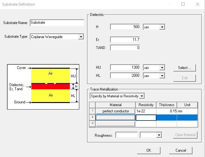

Ansys EmployeeI'm trying to replicate this error. What are you using for the values in your CPW substrate definition?Â
November 6, 2023 at 8:14 am
November 6, 2023 at 9:28 pm
Dan Dvorscak
Ansys EmployeeIt looks like the error is coming from the use of the "perfect conductor" material. It seems like this model is not tolerant of that material. I'm not sure why. It may be a bug, and I will check in with Ansys development.Â
