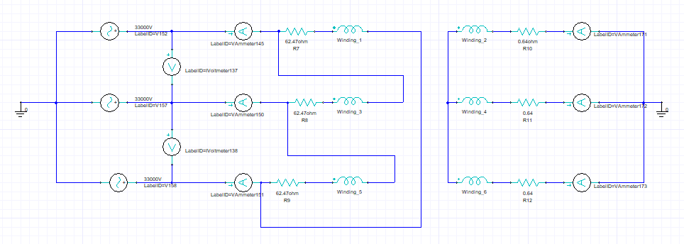

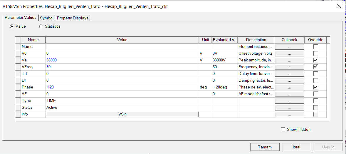

I am using ANSYS Electronics 2022. I created a circuit by using Simplorer for a transformer. And I created .sph file by Maxwell Circuit -> Export netlist.
Whenever I try to import the circuit on Maxwell 2D by assigning excitation -> External Circuit -> Edit External Circuit -> Import Circuit Netlist, I get the error message saying "Error encountered in importing file. Invalid .SUBCKT format in netlist file."

Ansys EmployeeHello,
The circuit picture you shared looks like most components are shorted by incorrect wires over them. Could you try removing those wires?
GL
May 9, 2023 at 7:09 pm
Ali Fırat Çobanoğlu
SubscriberHi Gluo,
Thank you for reaching me out. Yes, you are right, I made a huge mistake but after I posted it, I believe I made the required changes and re-drew it properly. Here's the changed version:
But, the problem is not solved yet. I don't understand why.

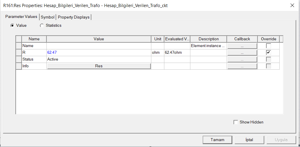

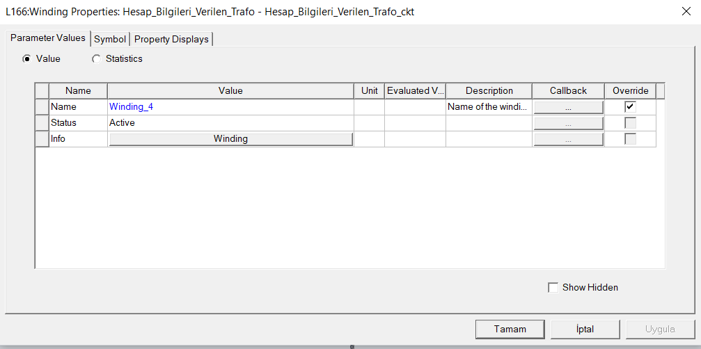

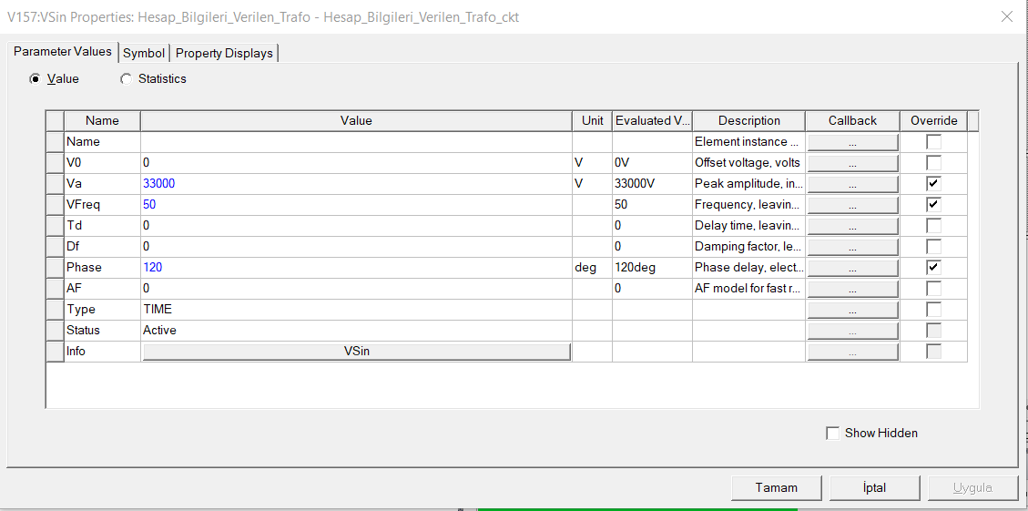

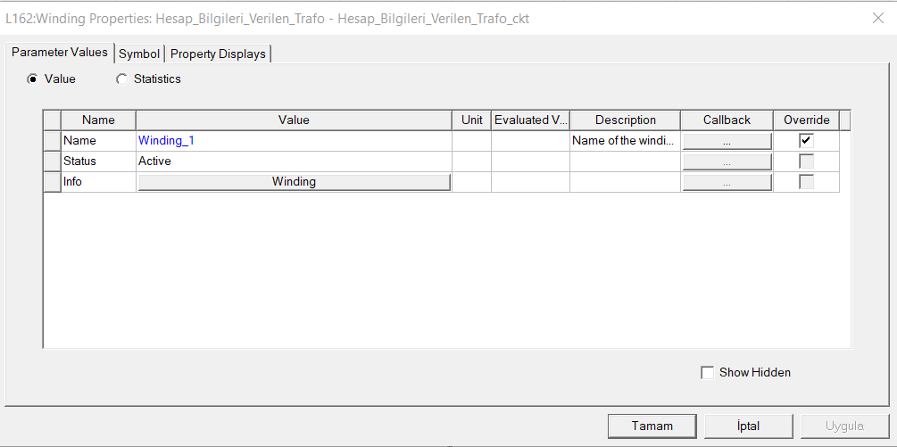

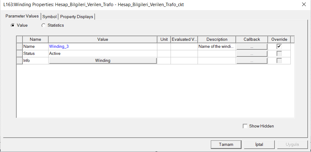

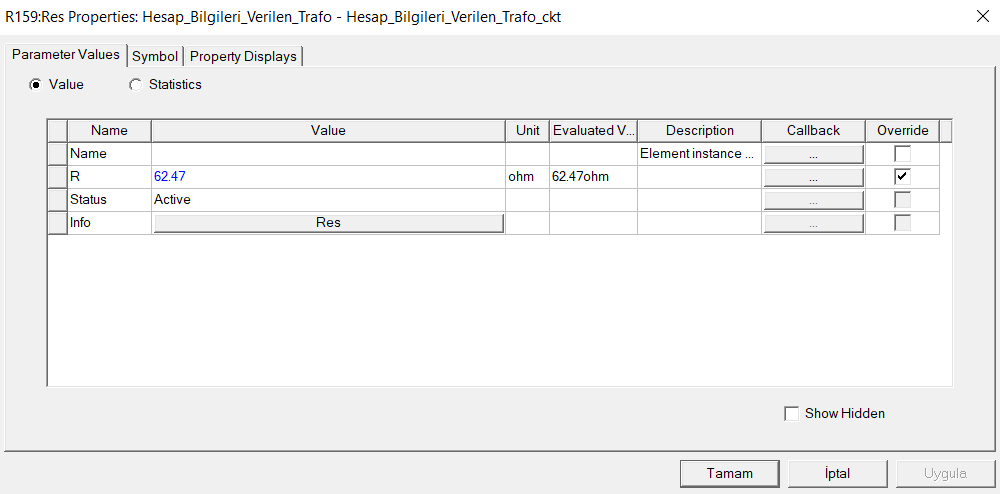

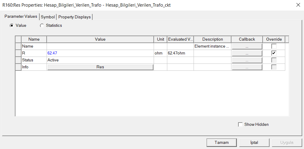

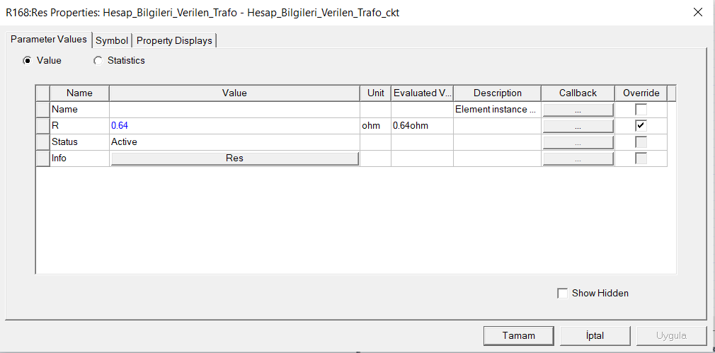

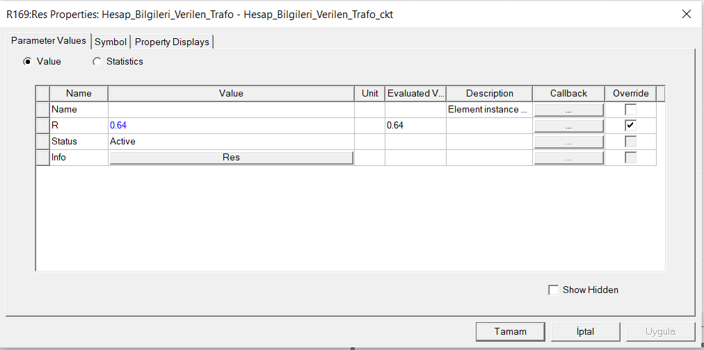

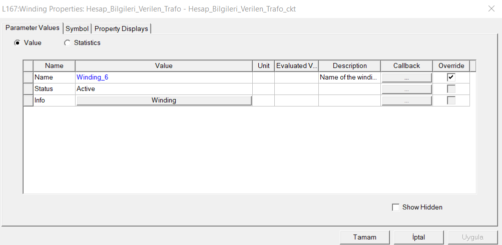

Here is the properties of each and every component that I used to draw the circuit.
And it shows nothing of course on Voltmeters and ammeters.
