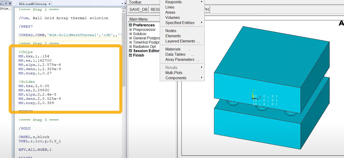

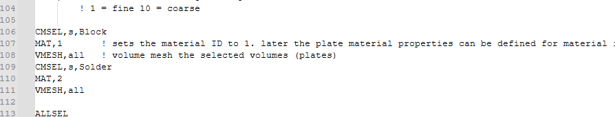

SubscriberIn the Ansys Innovation course: Intro to Ansys APDL Scripting Course - Solid Meshing Lesson 3 (Link:https://innovationspace.ansys.com/courses/courses/intro-to-ansys-mechanical-apdl-scripting/lessons/solid-modeling-meshing-lesson-3/), APDL code didn't mention any material. But MAT 1 and MAT 2 mentioned. After run the script Material data are not available. Is it by mistake or for this tutorial it may not required? Pl explain
