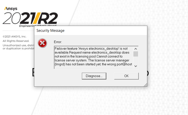

SubscriberAugust 26, 2021 at 8:18 pmANSYS_MMadore
Forum ModeratorPlease share the full error message. The message is cutoff, you can either expand the window or scroll down and take another screenshot.
August 27, 2021 at 12:40 ammgjeong
SubscriberFailover feature 'Ansys electronics_desktop' is not available.
Request name electronics_desktop does not exist in the licensing pool.
Cannot connect to license server system.
The license server manager (lmgrd) has not been started yet the wrong port@host or license file is being used, or the
port or hostname in the license file has been changed.
Feature
electronics_desktop
Server name
129.10.132.63
License path
1055@129.10.132.63;
FlexNet Licensing error
-15,10032
but the license server is working.

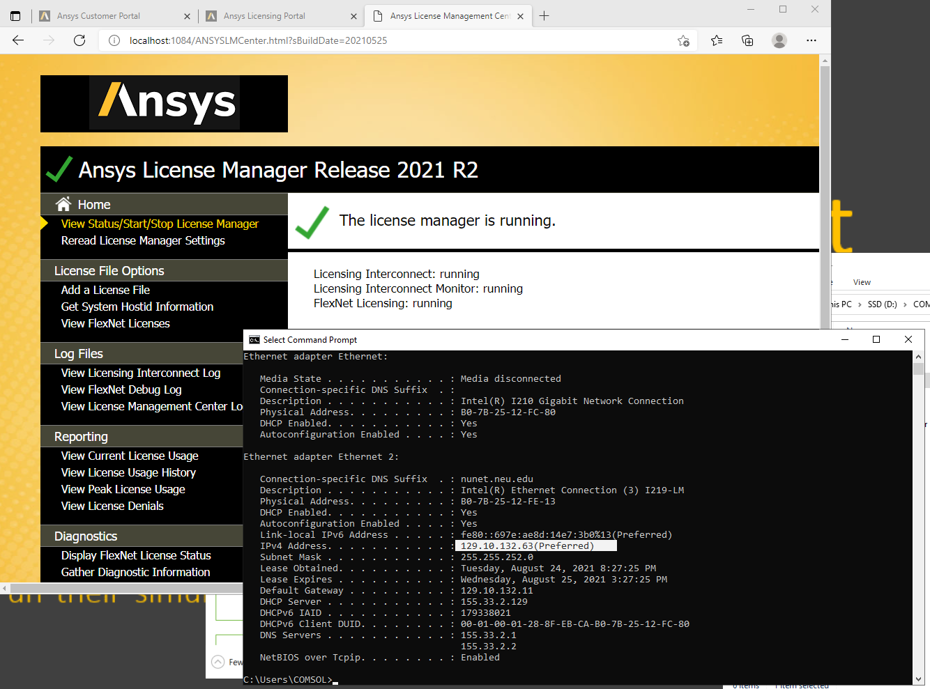

January 26, 2022 at 7:38 pmmgjeong
SubscriberI am trying to access the license server we set.
However, when I start Ansys Electronics Desktop, it shows this error message.
Feature
electronics_desktop
Server name
129.10.135.63
License path
1055@129.10.135.63;
-15,10032
I also did the ping test.
PS C:\Users\mingy> Test-NetConnection 129.10.132.63 -Port 1055
ComputerName: 129.10.132.63
RemoteAddress: 129.10.132.63
RemotePort: 1055
InterfaceAlias: Ethernet 2
SourceAddress: 129.10.135.203
TcpTestSucceeded : True
I also did
http://storage.ansys.com/doclinks/videos.html?code=ConfigFirewallExc-VLU-M2a
things shown in the webpage.
Could you let me know how to solve this problem?
February 17, 2022 at 12:43 pmANSYS_MMadore
Forum ModeratorPlease make sure the port for the ansyslmd daemon is open on the license server firewall. You can set ansyslmd to a static port by adding it in the license file on the VENDOR line.
For example:
VENDOR ansyslmd PORT=1056
