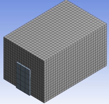

Ansys EmployeeIf you have that face use Groups in SpaceClaim to create NS.Â
In Meshing you can select face - right click - create NS.Â
Please go through help manual for more detailsÂ
Keyur
July 1, 2022 at 9:26 am
Rob
Forum ModeratorAnd to split the face you can use Imprint in SpaceClaim.Â

Ansys EmployeeMake sure you have that face in geometry. If you do not have that face in geometry, go to SpaceClaim and split the faces so that you have that face.Â
In SpaceClaim you can create NS using Groups.Â
In Meshing , select that face, right click and create NS.Â
