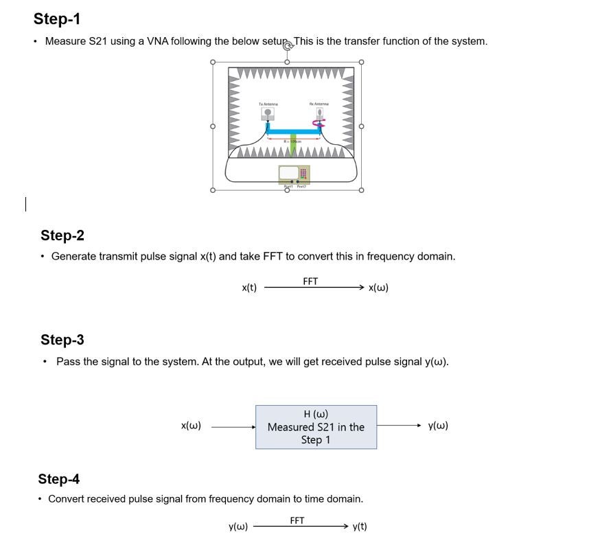

      I want to do time domain analysis of my antennas. I have a Tx antenna and a Rx antenna. Tx and Rx antennas are directed towards each other to recieve maximum radiation. I have connected them to VNA and measured S21 between them.
      Now I am willing to do some time domain analysis. First, I want to import the S21 in Ansys. Then I want to give a pulse signal at its input and want to check the output pulse shape.
      I have summarized the steps below.
      I want to know Is it possible to do step 2,3 and 4 in any platform of ansys?
    • Praneeth Munaga
      Hi mriheen,
      It is possible to carry out your setup using Ansys Circuit present in the Ansys Electronics Desktop. Kindly refer to the circuit help document and the available example files to get started.
