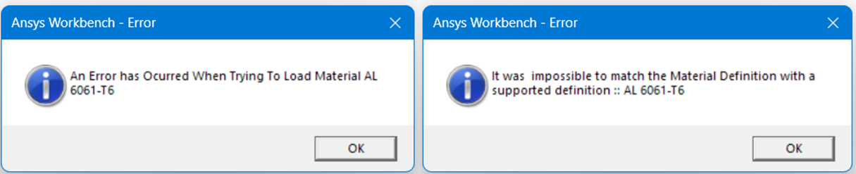

      I am trying to simulate the impact of a projectile agains an Aluminium plate using LS-DYNA. When I select the Al-6061-T6 from the Explicit Materials library, I receive the followig errors:
      I saw this post with the same issue, but I am an Ansys noob and I don't know how to proceed with the suggested solution.
      Could anyone please give me some hints?
      Thanks,
      Henrique

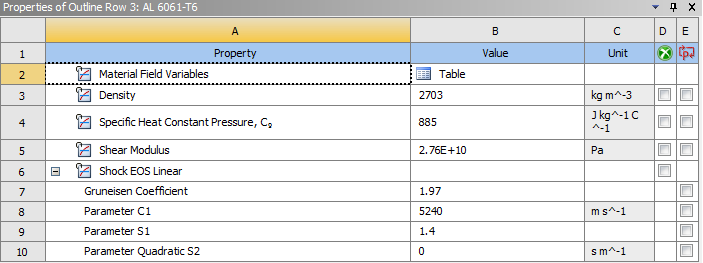

      Fix: First of all filter the engineering data as follows :
      then for the AL6061-T6, You will see that the software makes a compatible version suited for the lsdyna solver.

    • henrique.geraissate
      Hi Ram,
      Thanks for the answer and your time.
      Unfortunately, even when I filter the engineering data sources like you did, I keep getting the exact same errors. This was also true for other materials such AL 7075-T6
      I was then looking for the input.k file, getting the lines that define the material I want and putting that as a command snippet under each part (changing the part ID in each snippet). Now the error changes to: "An error ocurred inside the SOLVER module: general error" and "An exception occured when generating the input file, check the extensions log for further details".
      Any ideas on why this is happening? I am happy to provide more details if needed.
      Best,
      Henrique
      Sorry, forgot one question:
      In explicit analysis (being autodyn or ls-dyna), is it possible to use material definition with only a Multilinear Isotropic Hardening as model?
