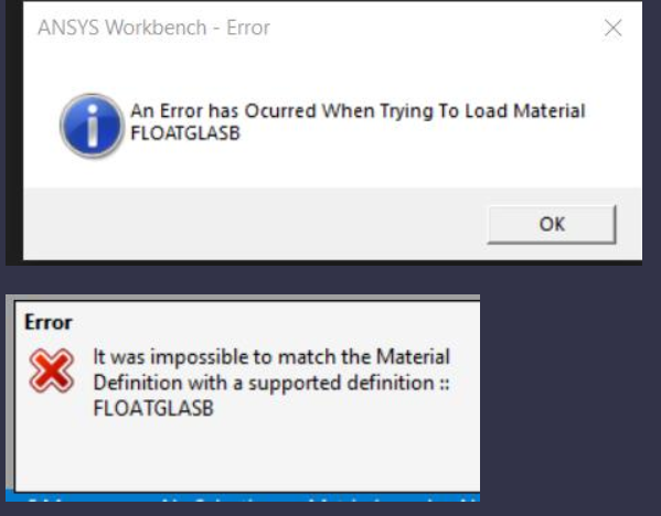

I am trying to simulate an impact of a glass with one of the explicit materials already loaded in the library, but when solving I get this error, can someone help me?
April 30, 2021 at 6:34 amRam Gopisetti
Ansys EmployeeLsdyna by default doesnot support all material in explicit material library, you need to search for MAT_GLASS (280) and MAT_LAMINATED_GLASS(038) model values and insert it as commands to the body.
