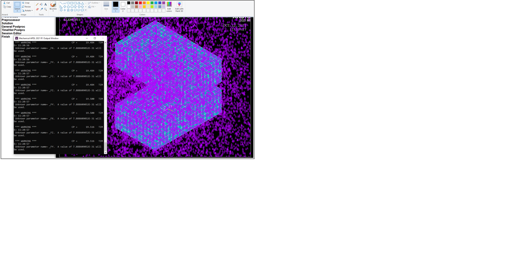

SubscriberI am using Solid 236 element.

October 13, 2021 at 4:11 amsupreeth.k
SubscriberThank you Ma'am
I am attaching the screenshot of the error message.
The macros for the above simulation was taken from the Ansys tutorial.
And I have made no changes to the Macros.

October 14, 2021 at 12:56 pmAshish Khemka
The message in the Output Window shows a warning regarding the unknown parameter names. The parameters _FX, _FY and _FZ looks undefined.
Regards Ashish Khemka
October 16, 2021 at 12:47 pmsupreeth.k
SubscriberBut I have used the same program that was given in low frequency analysis of Ansys guide. When I copy the macros, it should give the force between two magnets right??
