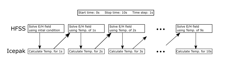

SubscriberHi, we are doing some research related to EM loss and heating rate by HFSS and Icepak. We use materials with dielectric constant varying with temperature, and our purpose is to compare heating rate between different materials. Hence, we're thinking if we can make use of 2-way coupling with solution type: transient.
This is our guess of how 2-way coupling for transient type works (and also what we need):

Ansys EmployeeHi Can you please comment again with the image embedded in the post, since we cannot open attached files in this forum. That would help me to provide you a response.
Thanks Nikhil
March 23, 2022 at 6:28 amMarch 29, 2022 at 4:03 pmNikhil Tamhankar
Ansys EmployeeHi Thanks for attaching the image again. I just confirmed again and yes, the feedback you received earlier was correct. There isnt a live transient feedback from time step to timestep as of now in the 2-way coupling workflow. However, ANSYS will definitely announce it if implemented in the near future.
Regards Nikhil
