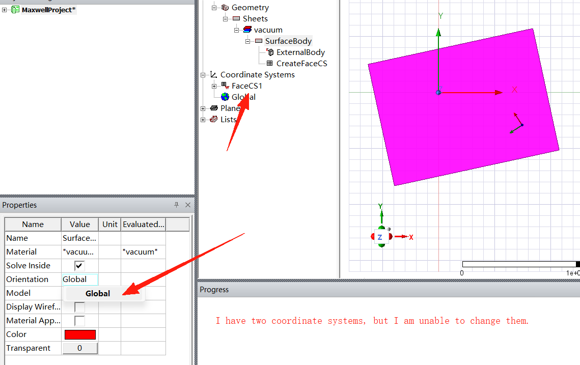

      I modeled in the design modeler of Workbench and then imported it into Maxwell 2D. However, I was unable to change the coordinate system of the object in Maxwell. Although I had created a face coordinate system based on the object.The version I am using is 2023R2. I attempted to perform the above operations using 2020R1, but found that the old version can support these operations.
    • 1439565790
      I have two coordinate systems, but I am unable to change them.I have two coordinate systems, but I am unable to change them.
    • MirandaH
      I did a quick test in 2023R1 and I'm able to change the orientation to face CS.
      Could you give it a try with standalone Ansys Electronics Desktop instead of going through Workbench?
      • 1439565790
        Yes,I can。
        • MirandaH
          Great, it's working with Maxwell 2023R2
        • 1439565790
          Thank you for your response and test. It seems that the answer to the question is quite clear. Both my 21R1 and yours 23R1 and 23R2 can accomplish this task. The reason should be related to my software or the computer itself.
