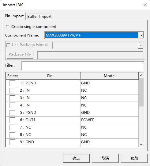

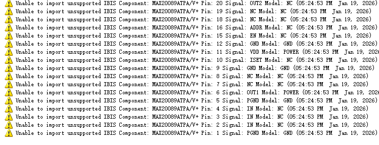

Ansys EmployeeHi Zhaoke,
您目前想导入的这几个Pin的Model应该是有问题的,可以先通过以下方法检查该IBIS模型。
When the AnsysEM has been installed, users can find the ibischk7_WIN64.exe file under below path (e.g. 24R2 version):
C:\Program Files\AnsysEM\v242\Win64\spisim\spisim\modules\ext
1) Open the CMD window
2) Change the path with:
>>> cd C:\Program Files\AnsysEM\v242\Win64\spisim\spisim\modules\ext
3) Execute the ibischk7_WIN64.exe with below command:
>>> ibischk7_WIN64.exe “C:/temp/demo.ibs”
