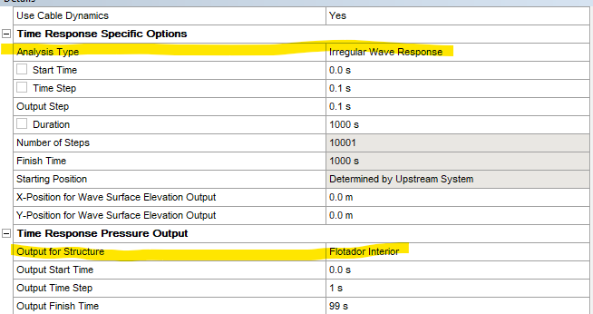

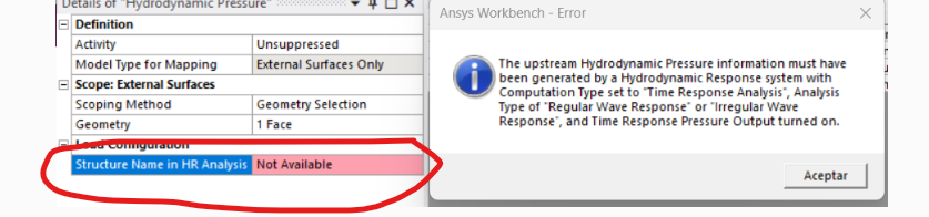

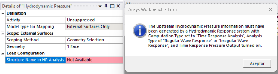

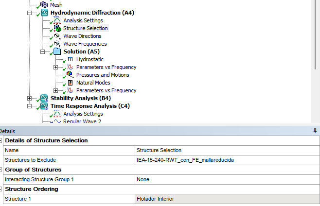

Can you check why your "structure name in HR Analysis" is not set. When your Hydrodynamic Diffraction analysis contains more than one structure, you must select the name of the structure (in the Hydrodynamic Diffraction system) that you intend to map loads from using the Structure Name in HD Analysis option.

In the first screenshot you shared, it should be scoped to geometry where you're intending to apply the load (As the Ansys help document suggests). I'm not familiar with your workflow, perhaps sharing more data like your model screenshots and what you're trying to accomplish would help other engineers solve your issue.
