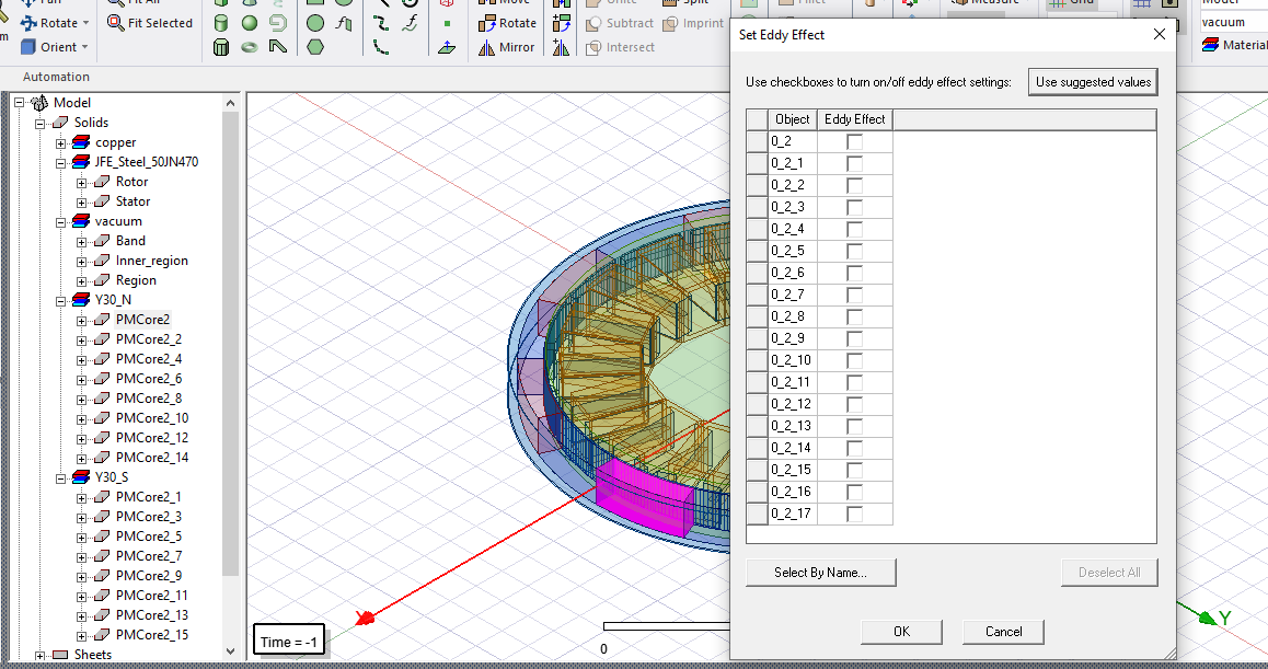

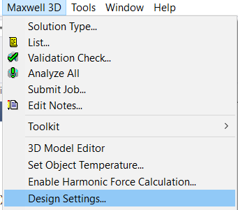

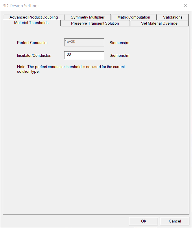

Forum ModeratorHi @Johnny_Monorail You need to make sure of two things.
Magnet should have defined non-zero conductivity in the Material properties.
Under Maxwell 3D>Design settings. The insulator value should be less than the conductivity defined in the Magnet Material properties.
Then it will show up in the eddy effect settings.

September 1, 2021 at 9:49 amJohnny_Monorail
SubscriberThanks a lot !
The solution works great. And I'm able to plot the eddy losses for rare-earth magnets. What about ferrite magnets though? Maxwell shows a default conductivity of 0 S/m (for grade 'Y30'). I understand ferrite material is supposed to have very low eddy loss, but 0 S/m seems a bit far-fetched. Any comments?
September 2, 2021 at 8:35 amNavya Chode
Forum Moderator@Johnny_Monorail If you have manufacturer data for the Y30. You can always clone and edit the materials in Maxwell library.
Eidt and use the material if you know a more accurate value.
Regards Navya

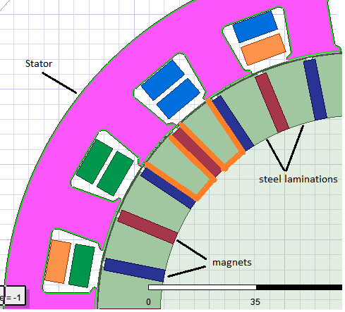

Subscriber@Navya C I have two questions related to eddy losses in permanent magnet rotors:
- Is there a way to model permanent magnets with a very thin coating of another conductive material, say Nickel, in Ansys Maxwell 2D and 3D transient simulations?
- For a motor model such as the one shown below, in which Nickel coated spoke-type permanent magnets make contact with the exposed (non-insulated) cut-edge of the steel laminations (highlighted in orange), what is the best way to model these conductive surfaces in ansys maxwell? I believe the conductive magnets are in a way short-circuiting the steel laminations and I have proved this experimentally. Will Ansys Maxwell accurately capture the eddy-current losses in the magnets and steel if I simply set the steel composition as “lamination?” Please advise.
