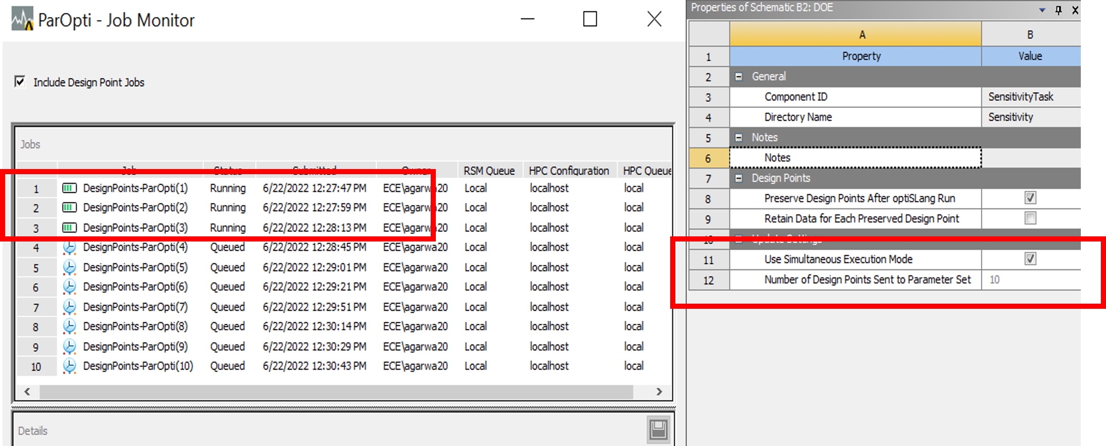

SubscriberI am running an optimization using Ansys optiSlang in Workbench. For the sensitivity analysis step I am creating a design of experiments using a sampling scheme and a number of samples. I am unable to run multiple design points in parallel for the DoE. Below is the procedure I followed:
Step 1: Select properties for the DoE.
Step 2: Select simultaneous execution mode and choose number of design points to be sent parallely.
Step 3: Change update option from Foreground to Remote Solve Manager
Step 4: Checking the simulation, while running shows that the design points are being sent in parallel
Step 5: All resulting designs obtained are failed designs even though the for single design point at a time all succeeded.
Since optiSlang licenses have already been purchased with capability to run 200 concurrent simulations when driven through the optiSlang DoE, Optimizer, etc. this should not be a license issue. I request you to kindly help resolve this issue.
Thank you. -

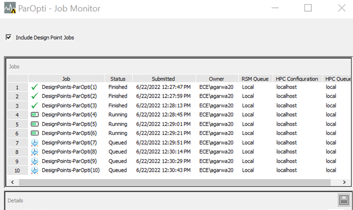

Thank you for your detailed explanation. I am able to run multiple design points together now. However, since I selected the execution mode as serial, I am unable to get an improvement in time required to solve the design points. Here is an image depicting the problem:
Even after selecting 10 design points sent to parameter set, and execution mode serial, only 3 design points were seen to be running at a time. I sent 10 desings in the parameter set as well. The time taken for completing execution of the three points was found to be approximately 3 times the time for single point update which does not solve my problem.In order to save time I want to run the multiple design points in parallel. What is limiting me here? Can it be related to number of cores or is there a problem in the simulation settings?

In general, longer time with RSM is somehow expected compared to running it in foreground. Using the RSM and design point update means that we .zip Workbench, execute it, etc. for each Job. There is some process overhead for that. If you use more Tasks per Job und less Jobs, you might reduce the overhead. So, this is a rather individual to configure.Parallel Execution:
From the "Job Monitor” picture it seems you submit the jobs to the local queue on your own local system. And in general, the RSM and ARC has some mechanism to avoid an overlade of the machine. You can check e.g. in the ARC Configuration under “Execution Nodes” the max. number of cores that can be used on the node.Also you can calculate the number of cores needed e.g. for 10 Design, 1 Core for each Design:
10 Designs X 1 Core per Design = 10 Cores
In your situation your system may be not able to handle more than 3 designs in parallel.Best regards,
