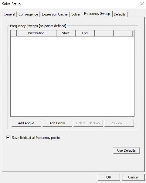

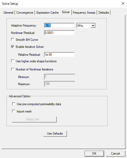

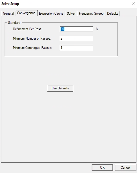

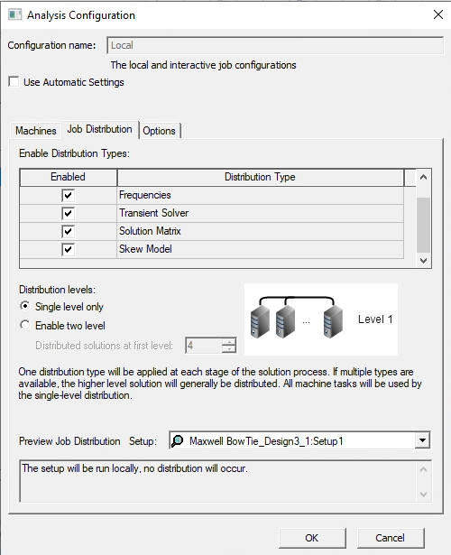

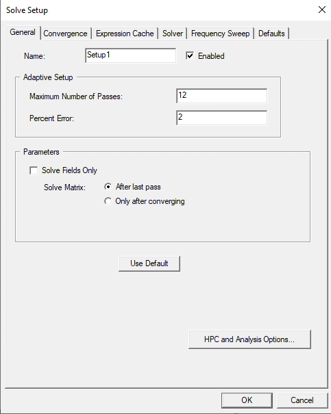

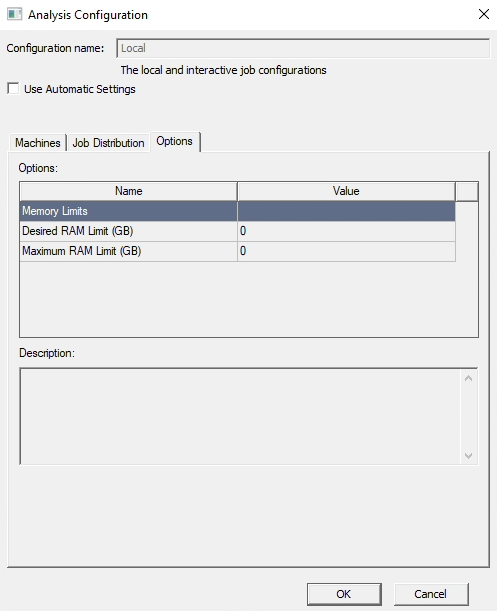

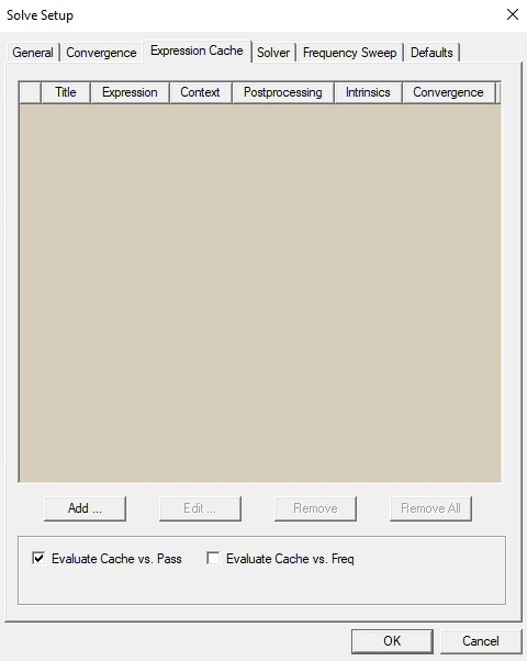

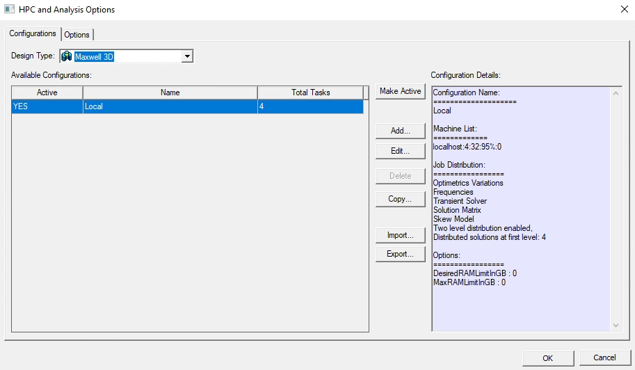

      Here are the HPC settings I have for the new PC hardware
      Here are the Analysis settings for running the simulation and solving the fields in Maxwell3D
    • GLUO
      You cannot assign only 1 task. For example, If you have 4 variations defined in parametric that need to be run at 8 frequencies, it is 4*8 jobs. You can assign 32 tasks and 32 cores to run the 32 jobs simultaneously if you have enough HPC license.
      GL
      • kedi
        Hello GL,
        Thanks so much for your response! For the aforementioned simulation, I only had one task, which was running the setup as shown in the pictures in my post.
        1. Do you mean I can see a significantly improved performance when I have more than variations defined, i.e., sweep one of the parameter variables in the Optimization?
        2. Could you elaborate on what you meant by "if you have enough HPC license?" Is there any way I can check it?
