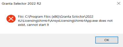

SubscriberHi George,
I've installed the package but now facing problem in setting up the license for it. There's 4 Granta selector licenses in my license pool, and the port being used was 2325 instead of the default 1055. When installing the package I keyed in the license server address as per my client licence setting, but got first error message 1 while trying to launch Granta selector from Workbench after restarting the PC.Â

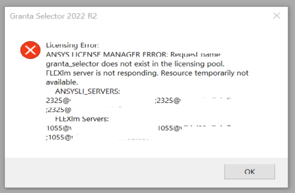

I tried reinstall the package after failing to find license configuration setting sepcifically for Granta selector, but this time with 1055 as port. Now I'm met with the 2nd error message.
Any idea how I can solve this apart from restarting the license server (it was at another continent with different time zone and can't be remote access from my side...) ?

December 13, 2022 at 1:52 am
George Karnos
Ansys EmployeeAre you able to check out ANY licenses from the license server that is on another continent?
What license maager is installed on the license server on another continent? It is ANSYS License Manager?
