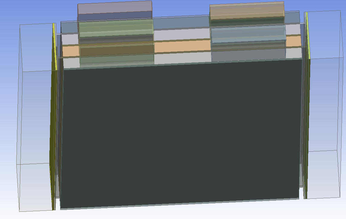

I need help regarding simplifying my battery thermal model by extracting heat flux data from battery model and use it for fluid domain separately.

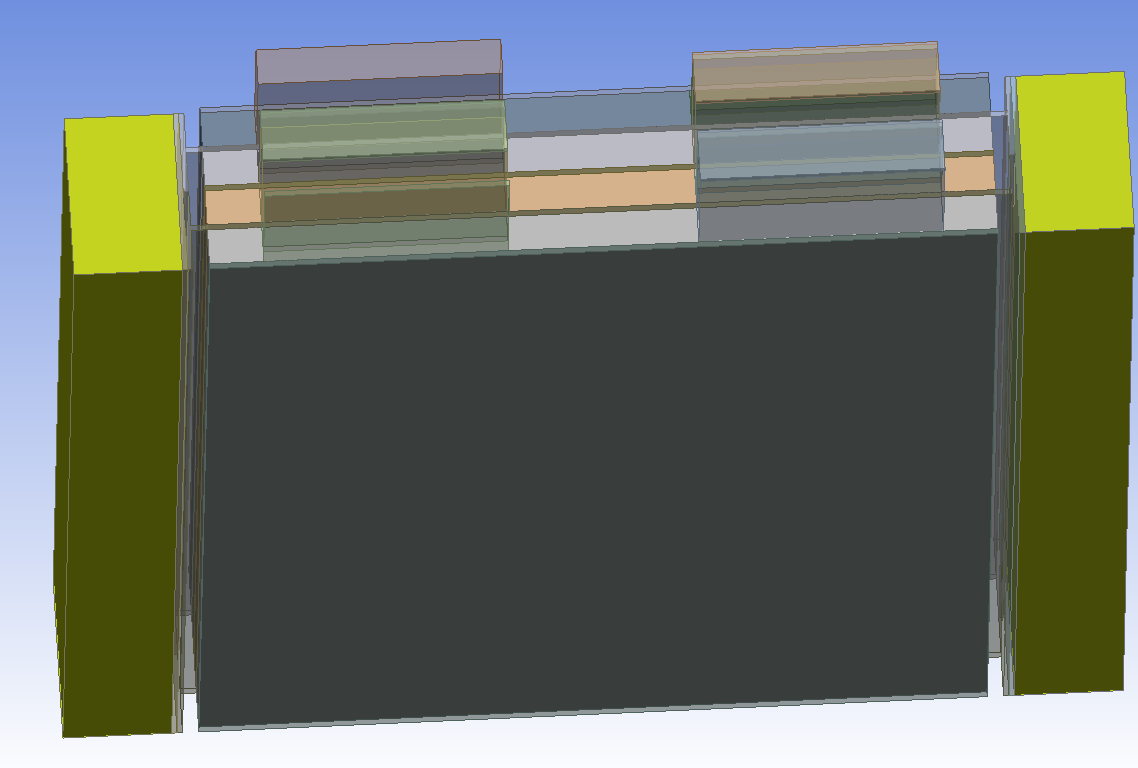

I have a battery pack model from which i have extracted surface heat flux vs time from a surface ( Fig 1 ), now i want assign this heat flux data to a surface adjacent to a fluid domain ( Fig 2)  so can anyone please tell how can i do this ?

SubscriberHello,
After obtaining the time-dependent heat flux values from the battery model, it is possible to use them as heat-flux boundary conditions for the relevant surfaces
Check how to assign time-dependent boundary conditions here: 7.6. Transient Cell Zone and Boundary Conditions (ansys.com)
If you are not able to access the link, refer to this forum discussion: How to access the ANSYS Online Help
Thank you,
Nikhil
April 14, 2023 at 9:25 am
Nikhil N
SubscriberAdditionally, have a look at this tutorial video
https://youtu.be/s_YkmvFH8VQ
