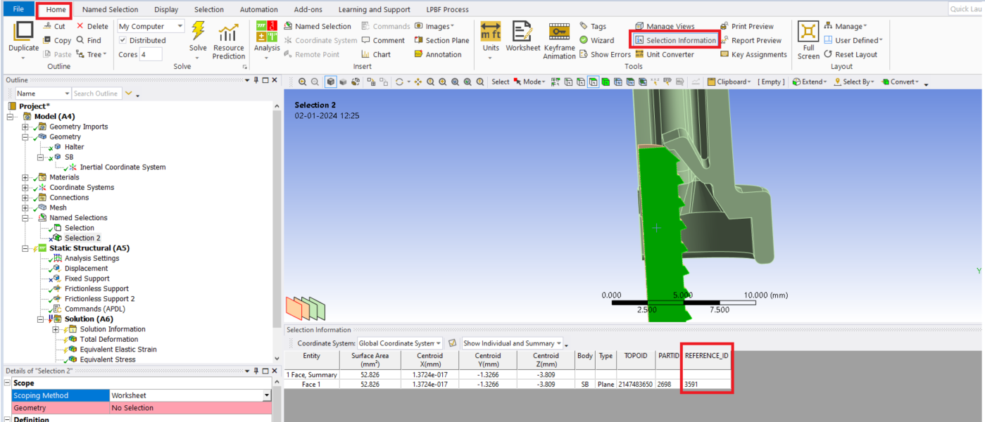

    • fan134
      Dear Erik,
      Thank you so much for your reply. I tried using "selection information" even before posting here but it didn't give me the ID of that face. And I tried your script too. Unfortunately, it didn't give me the ID as well. I've attached the pictures. Please take a look.
      Can you suggest me any other way? Thanks in advance.
      Faysal
      • ErKo
        Hi
        We need to activate beta options in workbench to see the surface id in the selection info.
        See how to do that:
        https://www.youtube.com/watch?v=nne64wg-w5g
        For the script:
        To see/print it (face id) in the script/shell window where it says "Script Executed", just add this:
        face_selid = ExtAPI.SelectionManager.CurrentSelection
        print(face_selid)
