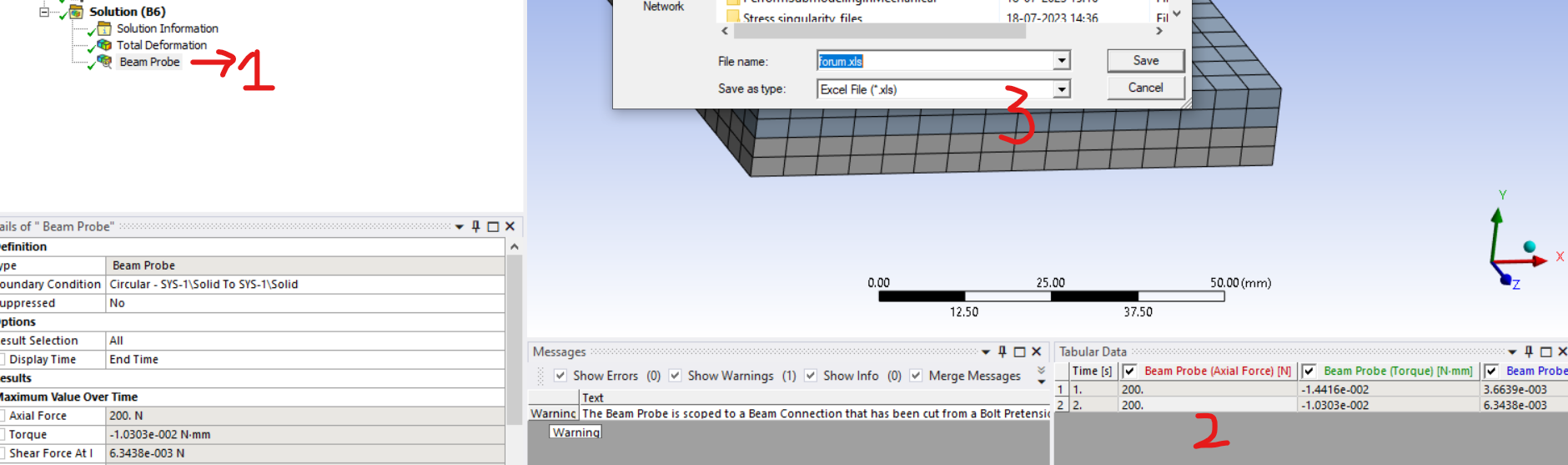

Ansys EmployeeHello Abin,
When you select the beam probe, and go to tabular data, right click and export. Default export is .txt format, but you can export .xls format also, it's available when you drop-down the "save as type" option.
Let us know if this doesn't help.
Nanda.

SubscriberYes it helped ?
