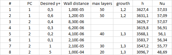

May 7, 2021 at 12:12 pmDio
SubscriberThank you When I tried 10-15 layers, mesh quality is getting about 10e-3. When I try 20-50 layers, mesh quality increase above 0.15 and Nu and h results looks like in the table. for y+=5 Nu and h looks decreasing. I guess for k-w SST y+ below 1, Nu and h becomes very close to experimental results.

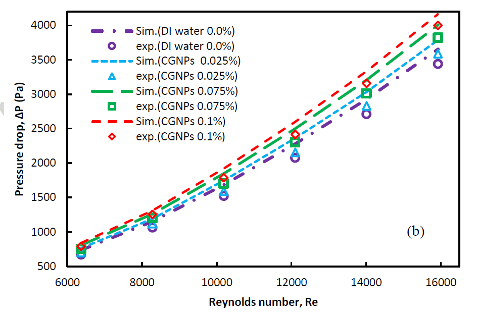

SubscriberThank you I think I get some good results. Errors were between 2-6% compared to experimental results. But how can I get pressure loss? analysis was periodic so outlet is disappeared when I defined periodic.
10mm length and 10mm dia pipe, original length 1400 mm and 1200mm portion has constant heat flux 12752 W/m2
May 7, 2021 at 4:02 pmRob
Forum ModeratorYou set pressure drop to get mass flow, so if you compare the pressure drop you set with your data how close is the mass flow?

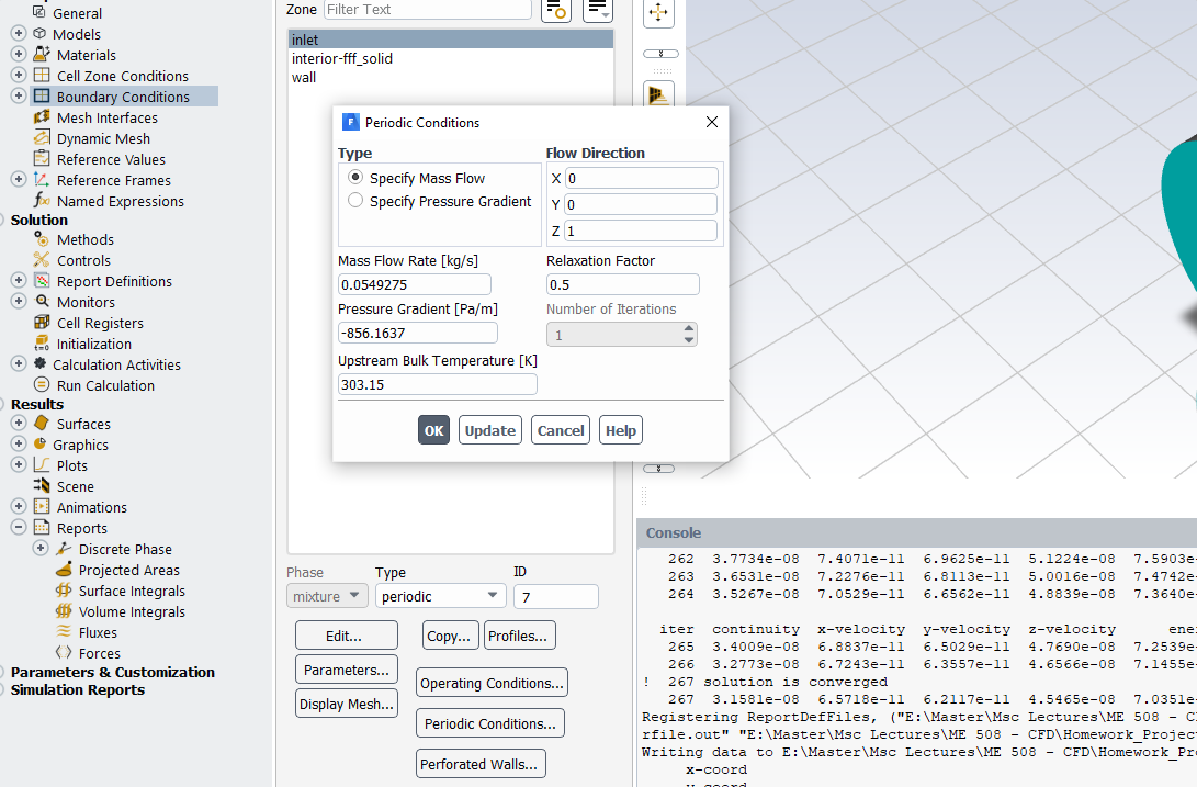

May 7, 2021 at 6:28 pmMay 8, 2021 at 10:48 amDio
SubscriberI trid different mass flow and after calculation I realiezed that, in periodic condition, pressure gradient changeed 0 to -856.163 Pa/m
when I multiply this value with total pipe legth I get very close value with figure I shared. I believe this approach is correct ?
Can I see this value by using "Reports" ?
May 9, 2021 at 9:11 amRob
Forum ModeratorPeriodics and reports are a bit messy as you have a pressure drop and "pressure" is relative as we have incompressible flow: have a look and see what you get. That's why the periodic panel is the way it is: you see the pressure loss per metre & mass flow.
May 9, 2021 at 9:19 amDio
SubscriberThank you it looks like it is better to write pressure drop formulation for turbulent flow as expression to see what I will get.
May 10, 2021 at 9:12 amDrAmine
Ansys EmployeeThe Pressure loss will be that pressure gradient by the length of the pipe. So your approach is correct.
