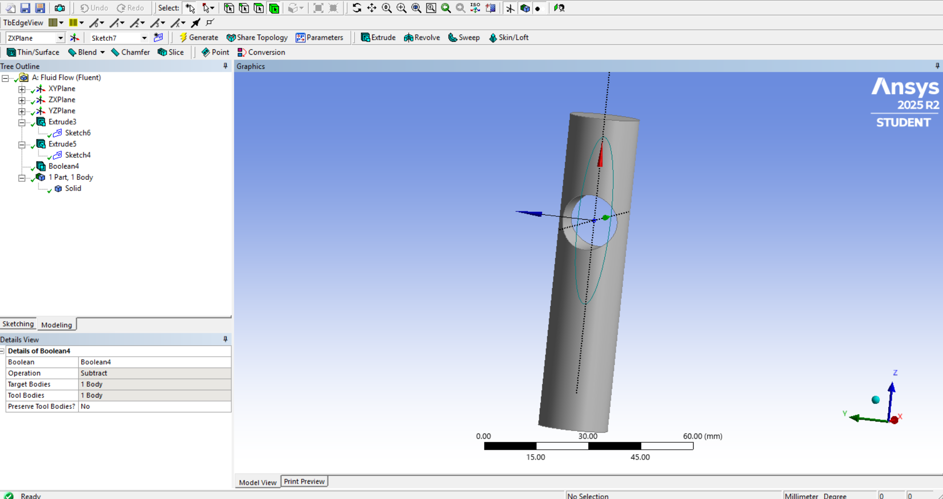

SubscriberThis is what I have made, solid fine particles will be dropping from the hole on the top, then passing through the sun rays as they get heat and settles at the bottom. The sun rays enters from the one hole by the side and exit from the other. Do you think that this geometry is making sense, what do you think?
January 22, 2026 at 10:07 am
Rob

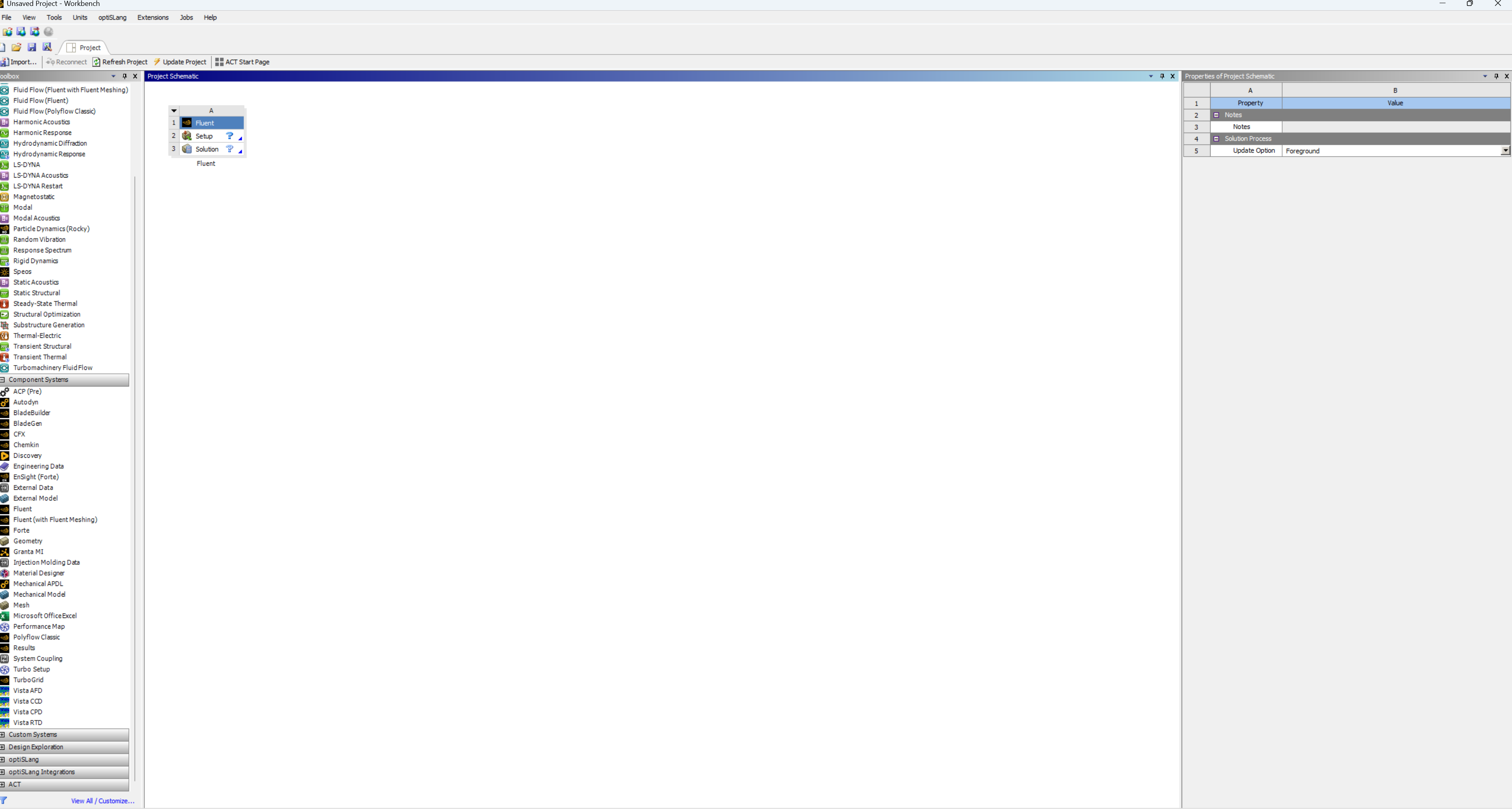

Forum ModeratorIt's not going to work. How will the particles fall through the hole? Have you run the tutorials in https://ansyshelp.ansys.com/public/account/secured?returnurl=/Views/Secured/prod_page.html?pn=Fluent&pid=Fluent&lang=en ?
January 22, 2026 at 2:05 pm
January 22, 2026 at 2:08 pm
Rob
Forum ModeratorI suspect you grabbed a Component and not a Workflow.Â
January 22, 2026 at 2:12 pm
eme5512
Subscriberok this helps, am sorted with that now.Â

January 22, 2026 at 2:20 pm
Rob
Forum ModeratorYou need to create a pipe. If there isn't a volume present (ie your hole) there is nothing to solve the flow on: your geometry becomes your mesh. The heat/whatever then needs adding from the side (face) of the domain or from a separate cell zone depending on the approach taken.Â
CFD geometry is different to Mechanical (and CAD) in that we use the "wet" bit of the domain and generally don't worry about the metal bits. So a pipe would be the region with the water in it, and we'd not usually model the casing.Â

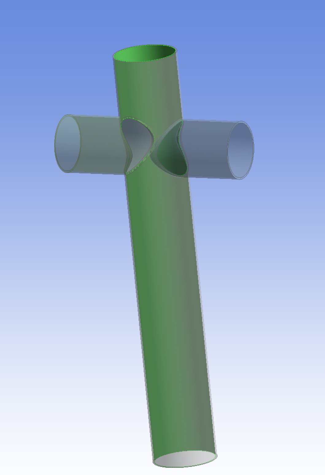

SubscriberSo I will have one volume for the pipe and another volume for the tank. The sun rays will have to pass through the pipe
I am the supervisor of the work
January 22, 2026 at 7:17 pm
January 23, 2026 at 9:43 am
Rob
Forum ModeratorThat's the metal part. So, if you extract the fluid then yes, that will work.Â

eme5512
SubscriberUnfortunately not working out pretty well. The geometry is all hollow. You mean I should extract the volume and not use the fill to create the fluid region?
January 27, 2026 at 3:23 pm
Rob
Forum ModeratorYou need to have mesh in the fluid parts. So you will need a volume (solid) there.Â
