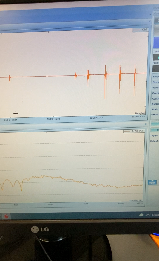

SubscriberHi everyone,
I am modeling piezoelectric ceramics in ANSYS APDL for force sensing application. After defining the material and applying a certain load to the PZT disk, I can get a voltage value from the disk. But this voltage is in open circuit condition. For example, by running the modeling in transient analysis and applying a dynamic load, the voltage signal exactly follows the strain signal, and of course, the value of voltage is too high like 30V. I could verify the voltage amplitude by the following equation to make sure my modeling steps are correct:

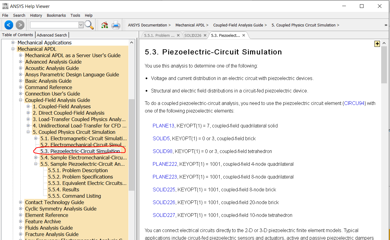

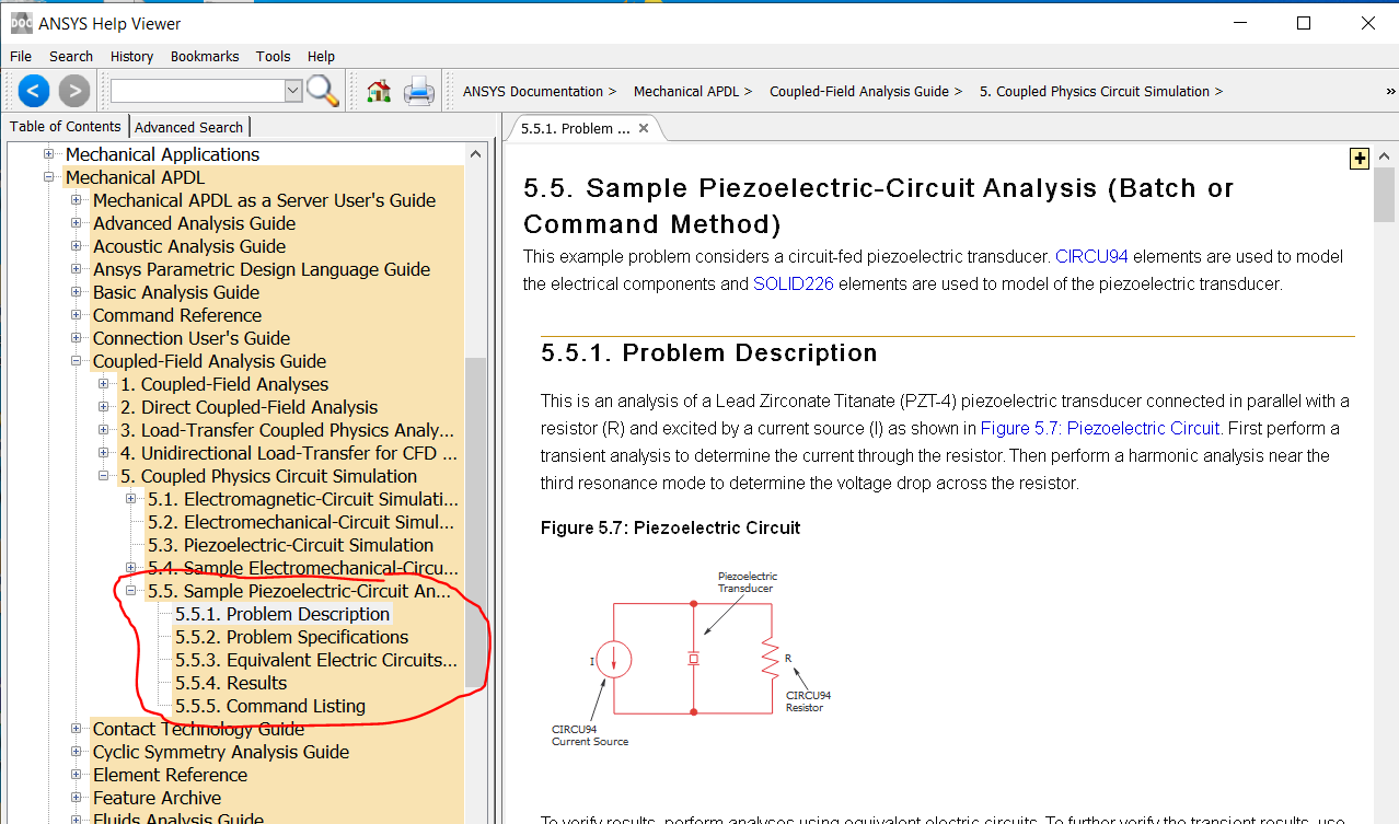

Ansys EmployeeHello Ali
We can couple CIRCU94 elements to the electrodes of piezoelectric elements modeled with charge-based SOLID226/227 (keyopt(1)=1001):
I'm quite certain we can also couple CIRCU124 to current-base SOLID226/227 (keyopt(1)=101).
Your objective reminds me of the worked example in the Help below, which demonstrates setup of equivalent circuit model of a piezoelectric device:
The following is a MAPDL example of a piezo transducer driven by a CIRCU94 independent voltage source and producing acoustic radiation. Post processing is used to verify that total supplied electric power equals total radiated acoustic power. This, of course, isn't exactly what you seek to do, but may nonetheless be helpful.

December 7, 2021 at 11:24 amsafiana
SubscriberThnak you so much for your response. I am not really sure if I have to consider another capacitance or resistance? Because already the capacitance of the pzt disk is considered in my model by defining the permitiity coefficients (I guess). One of the main problems is that when I apply a load by step function, the voltage signal exactly has a step function shape. However, in our experimental tests the voltage is like this:
The voltage quickly drops back to zero and it goes from positive to negative value. My voltage amplitude matches well with the open circuit voltage but how to make it like the experiment I don't know.
I appreciate any further suggestion.
Best Ali

December 8, 2021 at 2:14 amBill Bulat
Ansys EmployeeIf, upon the application of a time varying mechanical load, the measured piezo voltage oscillates and decays to zero before the applied mechanical load ends, then my guess is there must be other passive circuit elements connected to the piezo electrodes. Maybe there's some complex electrical impedance associated with the oscilloscope? Are you saying that a charge amplifier such as the one in the circuit diagram IS connected across the piezo terminals? If so, did you make an attempt to model the circuit to see how it would change calculated results?
There appears to be an Op Amp in the circuit. We don't have an element type to model these but they can be fashioned from a collection of other elements.
Yes, the finite elements comprising the mesh of the piezoelectric device have electric capacitance associated with them.
--Bill
