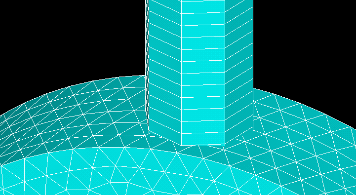

whenever I try to solve this model, consisting of different element types, I get this error:Â "There is at least 1 small equation solver pivot term (e.g., at the ROTX degree of freedom of node 138)."
I assume it is due to not connected beam-solid element interfaces. How is the connection properly done? It shall be fixed. A code snippet for APDL would be great.

Ansys EmployeeYou may use script based on the following hints.
r,1000
et,1000,175
keyopt,1000,12,3
keyopt,1000,5,3
type,1000
real,1000
e, !use beam node to create contact
et,1001,170
type,1001
real,1000
nsel, !use solid surface nodes to create target
esurf
