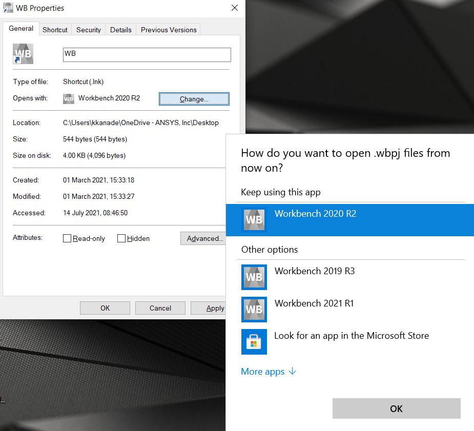

      Try following.
      It is wbpz file. Please open 2020R2. Then go to File - Open and then open it.
      Regards Keyur

      Thats true it opens in that way. I'm aware of that.
      But the problem is when i want to open an Archive, what will happen is 1st it will save the file then it will open. I need a solution which will help me add differnt version in the "open with" options. Then what i can do is directly click on it and open the project in the version of my choosing.
      As i said earlier i have 2020 R2 and 2022 R2. But getting only one option in "open with".

      No. It doesn't show in "more Apps". Tried to go trough "look for other app on this PC" in the installled path "C:\Program Files\ANSYS Inc\v202\Framework\bin\Win64\RunWB2.exe", but when i try to open, it opens in 22.
      If you run the above exe directly what opens? There are file association settings in Windows that do "stuff", so you may find something is messed up with those.
