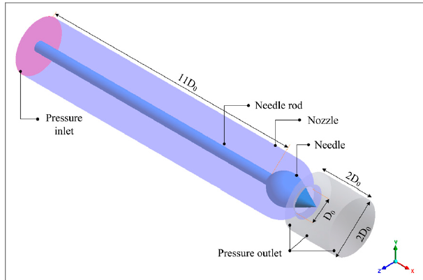

      I want to calculate Reynolds number in the geometry attached below, but I am confused about how to calculate the Reynolds number using Fluent?
      As Re=(fluid density*fluid velocity*characteristic length)/dynamic viscosity,  should i consider the characteristic length as inlet dia of flow (i.e., Dia of outer pipe - dia of small circular pipe) or it should be different ?

      Hi Rahul,
      In ANSYS Fluent and CFX, the Reynolds number (𝑅𝑒) is not always directly available, but you can calculate it using the standard formula.
      Regarding the annulus flow, I think the formula you have is correct.

      Thanks for reply, but I got confused as fluent show us turbulent reynolds number, should I rely on that or not, And moreover in fluent I can see molecular viscosity, turbulent viscosity, effective viscosity . Which one should I consider as dynamic viscosity for analytically calculating reynolds number ?
