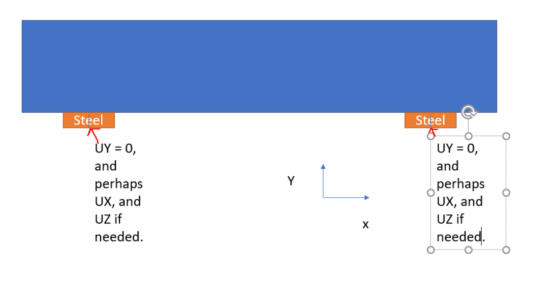

How to apply simple support to a reinforced concrete beam?
    • abhishek2011
      To analyze a simply supported beam with two point loading .
    • ErKo
      Recommended way of doing this:
      All the best
      Erik
    • abhishek2011
      Sir I'm asking about how to apply simple supports to a concrete beam which is at a distance of 200mm from the both edges.
    • ErKo
      Just fix the upward/vertical displacement of a steel plate that is connected at these locations on the RC beam - so split the steel plate in half and apply the vertical upward restrain on that split edge that will be OK. See sketch below
