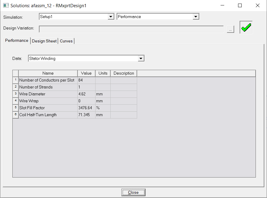

      while building a Maxwell model from an Rmxprt auto-assigned slot fill factor of around 8000% and after running maxwell design I received an error such as FE matrix could not be solved possible reason being unknown error or poor problem setup. does by any means this excess fill factor is causing error or not? Thanks in advance
      Yogesh
    • ymore
      to be exact, please see the image attached below
      I am working with 32gig ram and 16 core CPU, also with 1.5TB empty SSD. so the first possible reason can be discarded, I think.
      Wire dia. is from the manufacturer manual mentioned as 17 mm2 areas as
      So what are the possible unknown errors here or excess slot fill factor is causing the matrix to be singular. please recommend a resolution to these errors. Thanks for the help

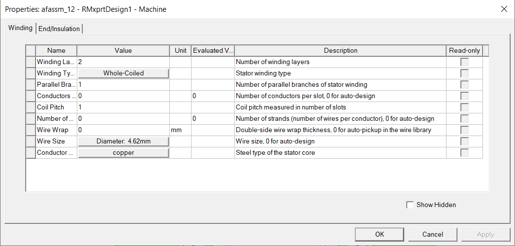

      Hi Navya for this particular Rmxprt results I have set up the following in the winding tab
      I left most fields for automatic settings. How does Rmxprt fill slot more than 100%? isn't it supposed in the range of 0-100?
      Does this information from the manufacturer about wire cross-section is correct or am I making a mistake while entering wire dia.?
      Thanks for your support.

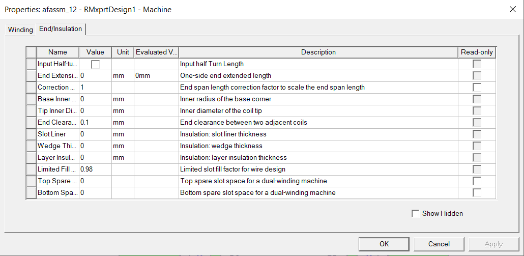

      I have added info as asked
      please comment further

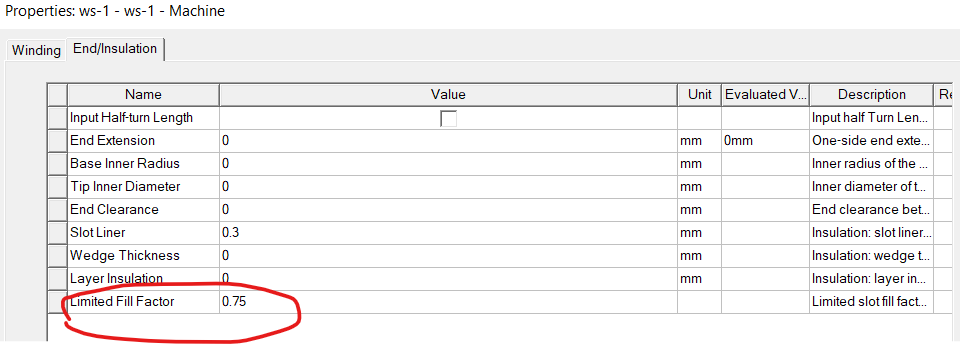

      Which machine type have you chosen from RMXprt Wizard?
      There will be a"Limited Fill Factor" option which will not allow fill factor more than what you set. default is 0.75. see below screenshot
      Can you check what is set for this option in your model?
      If this did not work, we need to check the whole model to figure out what's causing the issue.

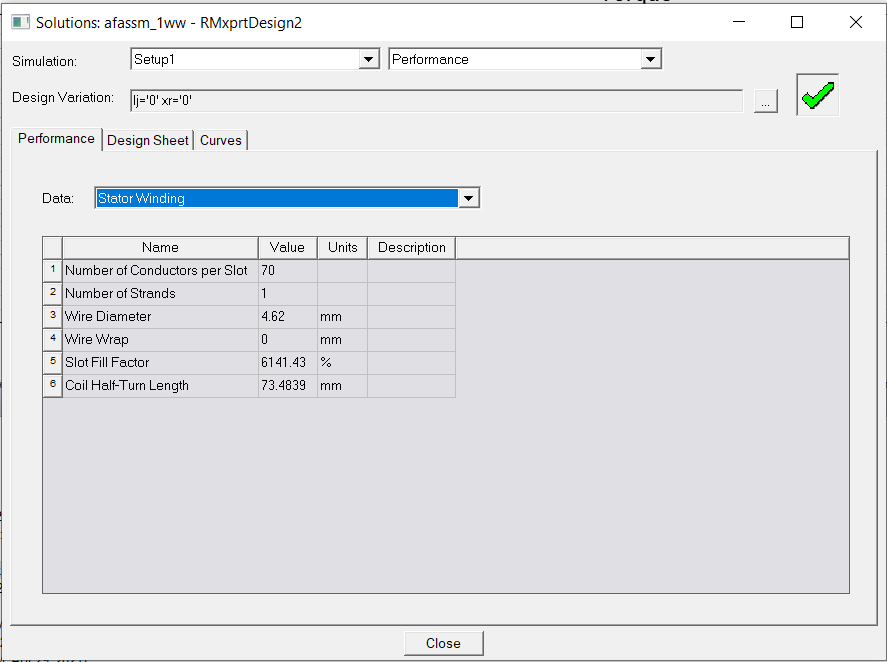

      Hey Navya Please see the attachment in the above comment as you asked for. In this design, I used the AFSM1 example inside the Ansys Maxwell library and changed data as per my requirement. It's been a while and I am waiting for your reply.

      I have looked at the file you provided. The wire diameter you provided (4.62mm) may be unrealistic in this case. The net area of the slot is around 51 square mm and RMXpert is giving a warning in the design sheet that slot fill is not possible for the performance you are expecting for the machine. I am also not sure if 98 % slot fill you provided is practically possible. Clearly, from the wire diameter, you have chosen No. of conductors required per slot can't be inserted into the slot.
      You can keep the wired dia also to zero in the setup and let Rmxprt figure out what diameter will fit all the required conductors in the slot for the required torque.
      Again, you need to cross-check the diameter auto-generated, whether it is practical or not. Otherwise, you need to play with other design parameters to achieve the desired performance.
      Once you run the analysis setup you need to open the design sheet from results and check the results if everything making sense and then only proceed for creating a maxwell design.
