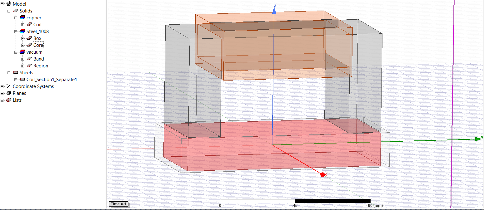

I am simulating an U-magnet and am having problems with the way the magnetic force is calculated in the model.
My model has: N=400 (turn), I=0,3(A), g=0,5(mm), A=0,0022 (m2) and m=1.04kg.

SubscriberI'm using Transient Solution type and force parameter is virtual force. I assign the force parameter for the box under the magnet.

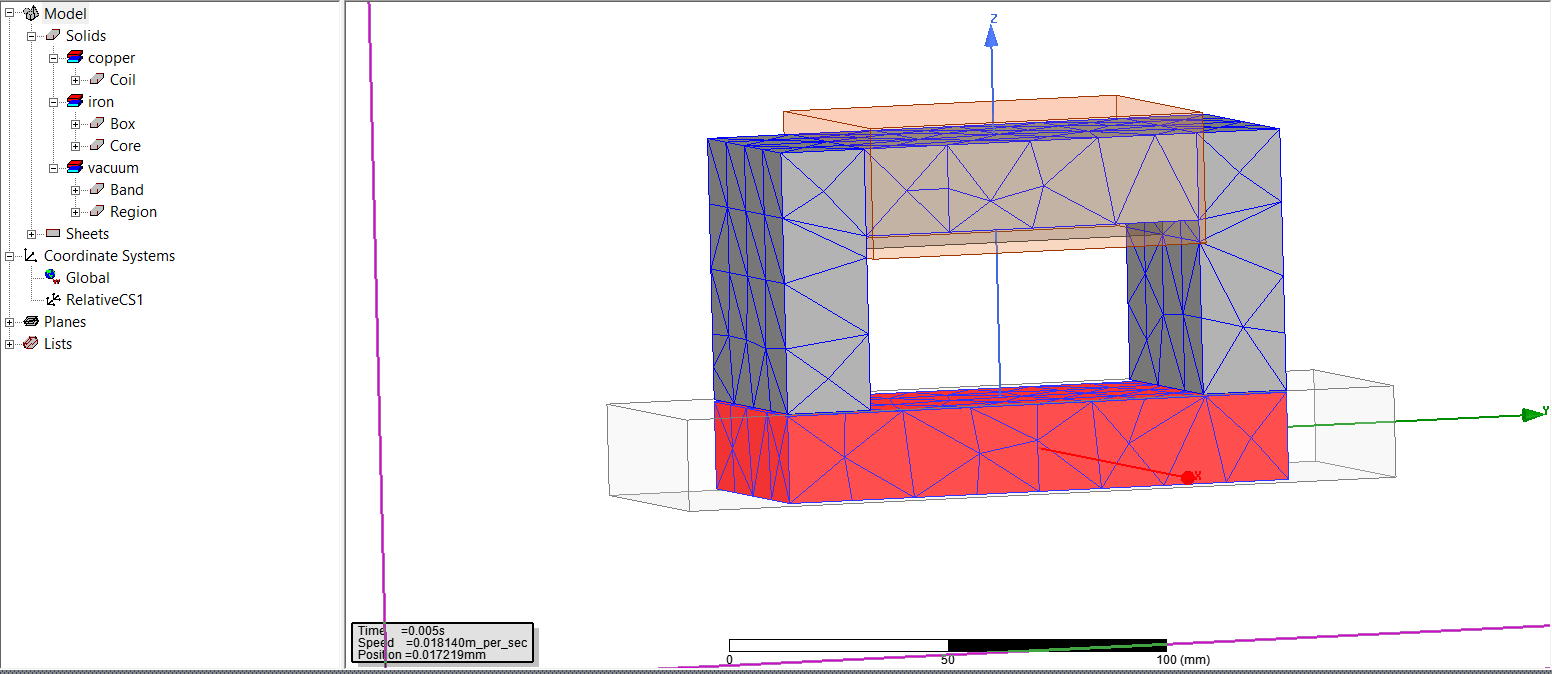

-Can you show us the mesh for this problem.
Can you put all the dimensions used in the problem and the force calculatd by maxwell?

SubscriberI used iron instead of steel_1008 with relative permeability is 4000 but the my calculation result still different from ansys.
I have 2 airgaps each of then with 0.5 mm of lenght in each leg. My calculation result is arround 39.81 [N] but ansys result is arround 20.6 [N].
I tried to use McLyman formula to calculate the effect of fringing flux (FF) but the result still so much different.
I want to use Transient solution to link with Matlab/Simulink and control the box position by controller in Simulink.

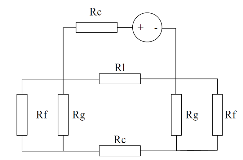

I used to use reluctance network to calculate inductance L=N*N/Rtotal ( neglect Rf: fringing effect, Rl: leakage flux)
Rtot=2Rc+2Rg, Rc=lc/(2*╬╝0*╬╝r*A); Rg=g/(╬╝0*A) -> L=(N*N*╬╝0*A)/(lc/╬╝r+2*g) -> F=(N*N*╬╝0*A*I*I)/((lc/╬╝r+2*g)*(lc/╬╝r+2*g))
With magnetostatic solver i can defind lc/ur=1,81/4000 but with transient solver lc/ur isn't constant.

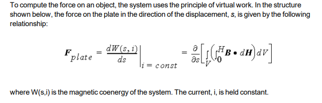

Ansys EmployeeMaxwell transient is calculating virtual force, you can search " virtual force" in manual to find the equation that the solver is using.
Note, when assigning virtual force parameter on selected object, user needs make sure the object is not touching any other object with a good distance air gap in between.
