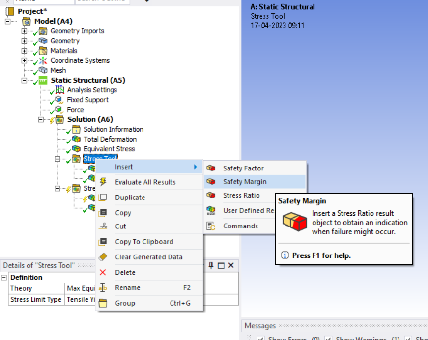

SubscriberCan you discuss, How you calculate stresses and strains in mechanical components and determine their safety margins?
April 17, 2023 at 3:48 am
Sampat Kumar
Ansys EmployeeHi Eden,
You can calculate the stress and strain in the Ansys mechanical during post-processing. create Geomtery-> mesh the model -> apply boundary conditions-> Right click on the solution and select the stress and strain according to the requirement -> right-click on the solution and select the stress tool -> in the stress tool select the option of " Max Equivalent Stress" then the "stress tool" will create under the solution tree. Right-click on the stress tool and select the safety margin option there.
