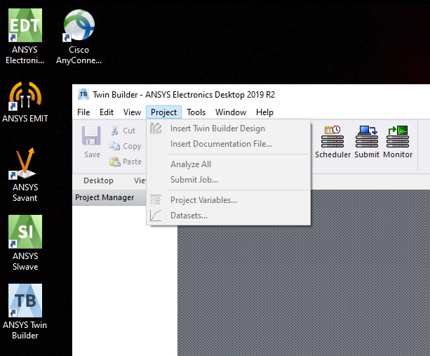

      The ANSYS electronics download from my university installed the following:
      Electronic Desktop, EMIT, Savant, SIwave, and Twin Builder.
      When I open the electronics desktop, it auto opens twin builder. How do I start a new HFSS project?
      Thank you
    • mbeliaev

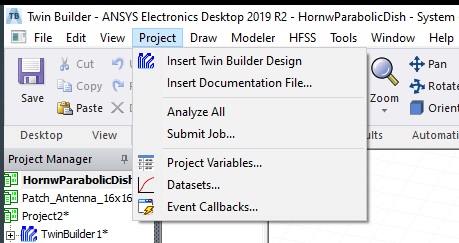

      go Tools-Options
