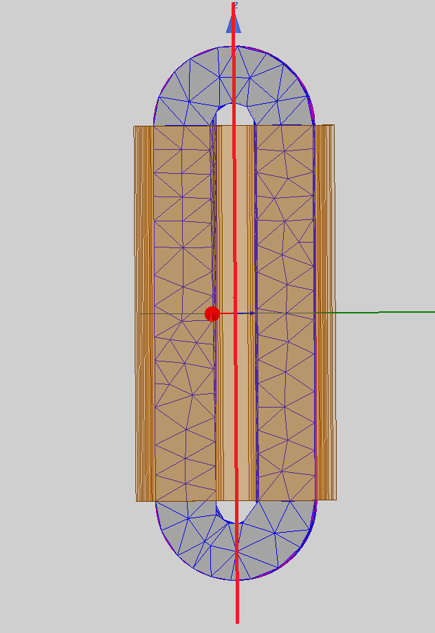

SubscriberI would like to create a mesh that is symmetrical on 2 sites of a plane.
I attached a picture below. This is a 3d model and i would like the mesh to be symmetrical to the red xz-plane that is shown in the picture as this red line (green line on the right is the y.axis).
As you can see the left and right side dont have the same mesh configuration, altough the model is perfectly mirrored around the red line/plane.
Can this be achieved somehow?
Thanks in advance
BR Lukas

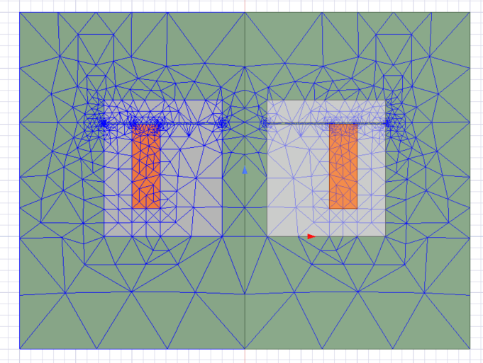

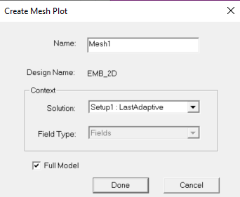

October 13, 2021 at 4:56 pmNavya Chode
Forum ModeratorHi @LukBlaz With the full model, you can not get the symmetrical mesh on both sides.
But you can run a half symmetry model and then select all and plot mesh. select Full model on the popup window.
If you didn't see the full model mesh, select all again and plot mesh and select Full model on the popup window again.
This will give you symmetrical mesh visualization on both sides.
Note that this will not solve the other half of the model. It's just because it's symmetric.
See reference pictures below
Regards Navya
