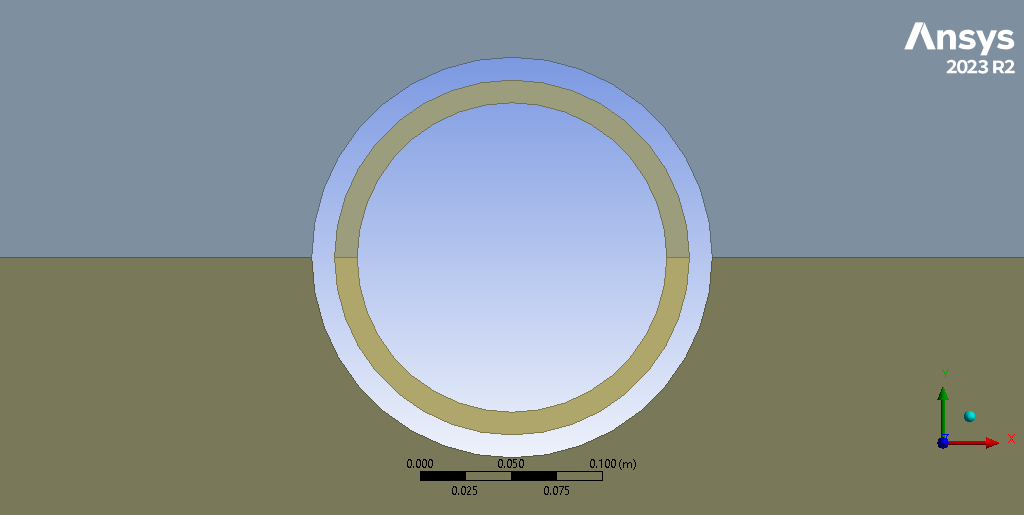

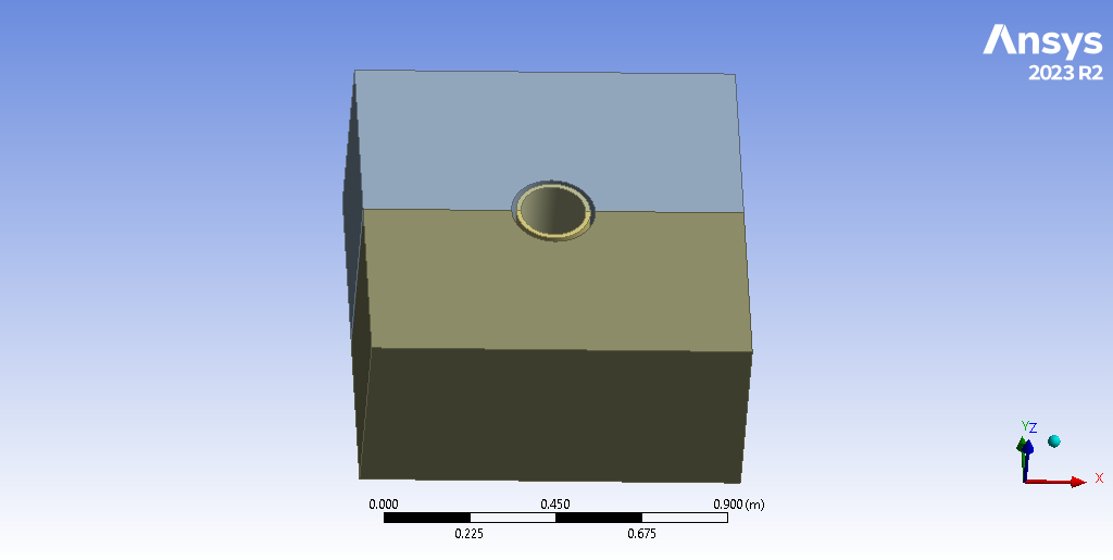

The cube is a rock body, the hole at the middle is a wellbore and the cylindrical body inside the wellbore is a casing. I want to apply fluid pressure at three surfaces: 1) inner surface of the wellbore 2) inner surface of the casing and 3) outer surface of the casing using the following code:

Ansys EmployeeThe images show you are working in workbench Mechanical. Why are you not just inserting a pressure object in the Outline? It handles the APDL commands. You can do that just to check in the ds.dat to see what APDL commands it writes. Select the analysis branch, and press "Environment > Write Input File" to write the APDL input file.

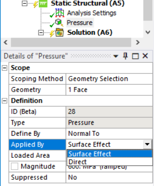

If you choose the ESEL item=TYPE, the documentation reads "Element type number" so that is what you use for VMIN and optionally VMAX. The Element type number is what gets assigned by the ET command. If you were selecting volume elements of a body, that would be all you need to do. but for applying a pressure on a face, there are no surface elements by default. If you look at the ds.dat after using a pressure load with the default options, you'll see it creates surface elements first. The pressure load shows you can select "Applied by" as "Surface effect" (default) or "Direct."
The "Surface effect" option creates the surface elements to apply the pressure load.

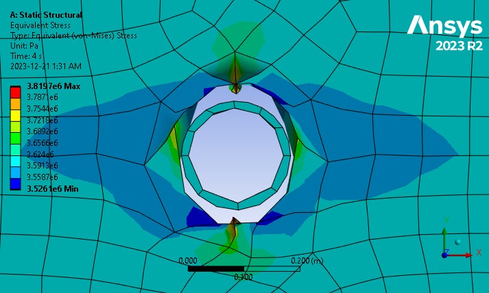

SubscriberThank you so much for your response. After applying the pressure, I'm getting deformation in the wellbore. But this shouldn't be the case because there won't be any kind of deformation in the wellbore. I tried to fix this by setting the displacement in the wellbore as 0. But, in that case, I was getting fixed stress distribution everwhere. Can you suggest me something? or is it possible for you to take a look at my model? Thanks in advance.

Ansys EmployeeYou orginally said you wanted to apply pressure to the inner surface of the wellbore as well as inner and outer surface of the casing. A pressure load is going to cause deformation in the real world, even if the material is very stiff, in which case the deformation would be very small. But the material must be free to deform if a pressure load is to make sense. Applying a pressure and a normal/radial displacement to the nodes is contradictory. It will probably ignore the pressure since a displacement is a direct degree-of-freedom load/support. If you are saying the material is so stiff that the pressure effect is negligible, then you are making an engineering assumption, and there's no need applying the pressure to the inner wellbore face. You might as well use a rigid body there depending on what you expect on other boundaries of that body, or not even include that body in your model.
Also the image shows the mesh is much too coarse on the wellbore and casing faces for an accurate result. Make smaller elements there. Also make sure to check the result with a scaling factor of 1 as a sanity check.
