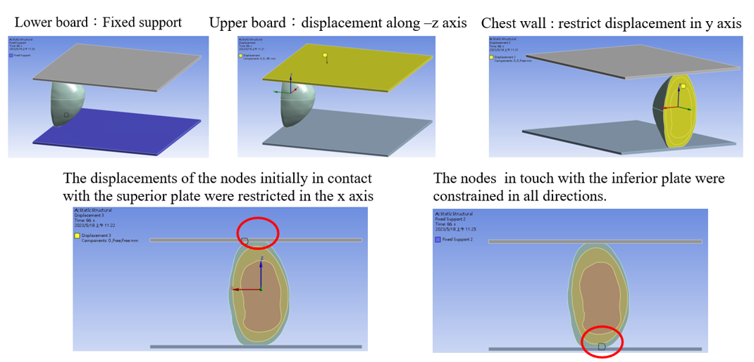

The boundary conditions are set as follows

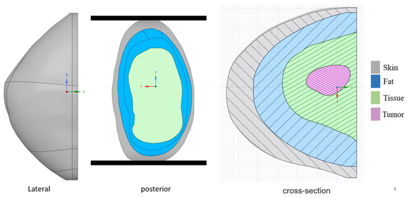

The geometry of breast as shown in the image below
The material properties are using the Mooney-Rivlin model, and the values are obtained from the paper.

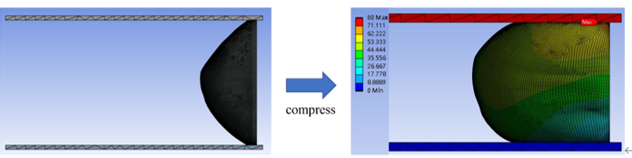

The mesh I use linear hexahedron and element size I use 1 mm , it can get 425681 nodes and 598742 element. And the average element quality is 0.77688.

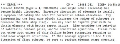

The goal is to move the upper board downward by 100mm to compress the breast. The simulation is divided into multiple steps, with each step moving the board downward by only 1mm. However, when upper board downward by 84mm, a high distortion issue occurs, as shown in the image below.

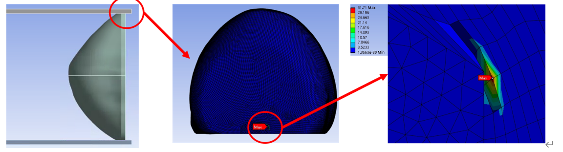

After the error occurred, I checked the residual force and found that there were no issues in other areas except for the initial contact surface between the breast and the upper board. Convergence issues were observed, and the mesh dostortion can also be seen, as shown in the image below.
I have already tried change element type into tetrahedron and add a nonlinear adaptive region, or decreasing the displacement values at each step, but it still cannot achieve convergence. I would like to know if there are any other ways to solve this error?

Hello Jia-Wei,
Hyperelastic materials such as rubbers are used in a variety of engineering applications for sealing and other purposes. In many of these applications, the components made of hyperelastic materials experience large strains, and modeling such cases often involves accounting for geometric, material and contact nonlinearities. Due to these reasons, we often encounter the excessive element distortion error when using hyperelastic materials in our simulation. In this video, experts discuss why element distortion errors occur and you get to learn how to understand various error messages and use them to diagnose and fix the underlying issues.
Let me know if this doesn’t help.

Ansys EmployeeHello Jia-Wei,
could you make the following changes and run the solution.
- Change the contact settings between displacement plate and your model
- Behaviour-->symmetric
- Normal stiffness-->Factor, Normal stiffness factor-->0.1
- Detection method-->Combined
All the best,
Nanda
