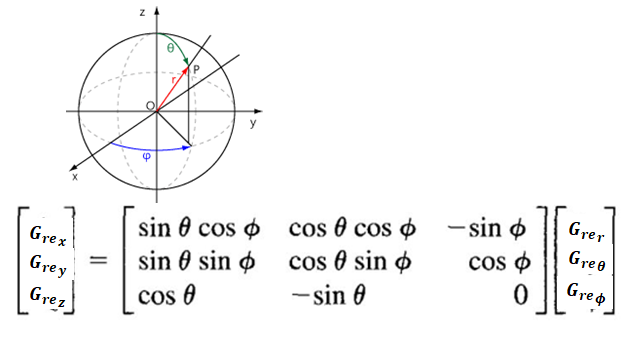

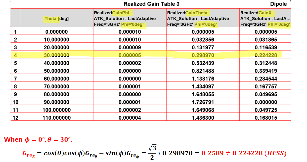

I obtained the theta & phi component of realized gain from dipole antenna simulation.
And I calculated the x component of realized gain from theta & phi component by using transformation relation between spherical and cartesian .
But, x component value that I calculated is different from the value from HFSS.
why..? It would be appreciated in advance if telling me the reason.

In the matrix conversion shared, I observed that the x component also depends on the r component. But in the last equation, only the theta and phi terms were used. May I know the reason?
