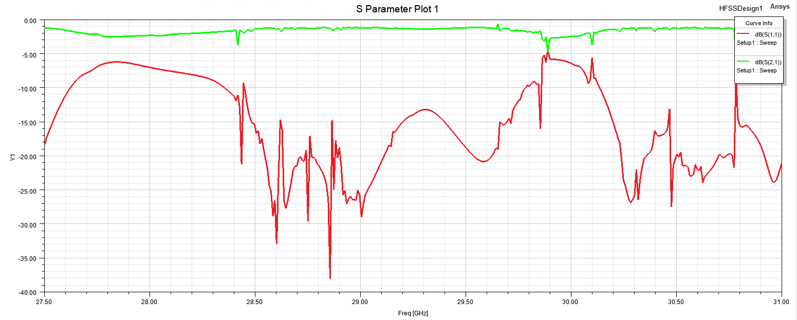

SubscriberI am trying to design a waveguide-to-microstrip transition for Ka-band operation, but my simulation results give me some very poor looking results as shown in the attached picture. Would this be considered resonance? Or have I improperly defined my wave ports and/or boundaries? I haven't been able to find a solution for this, meaning I don't know if it is a design issue or a simulation setup issue. has anyone ever seen something like this?

- Are you explicitly defining any surrounding region around the microstrip portion of the model?
If not, please add surrounding space and a proper absorbing boundary as the microstrip has fringing fields over the top surface. - Please see if the transition between the waveguide to microstrip is modelled correctly.
If possible please share the screenshots of the model to understand your case better.
