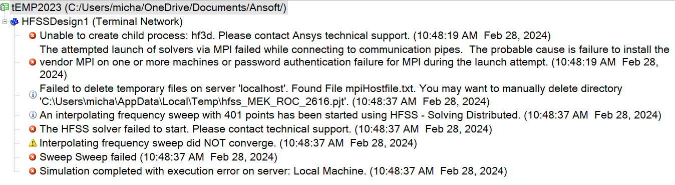

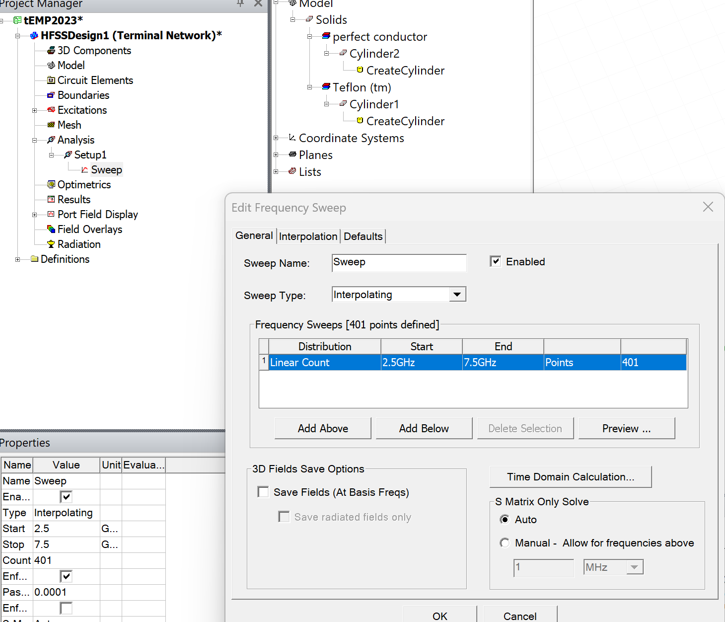

SubscriberI am trying to run a HFSS simulation, and it just hangs at the start of a frequency sweep.
Please note that I had deleted all version of HFSS and then reinstalled HFSS 2023 R2. Before uninstalling HFSS, I needed to use Task Manager and delete all processes associated with MPI.

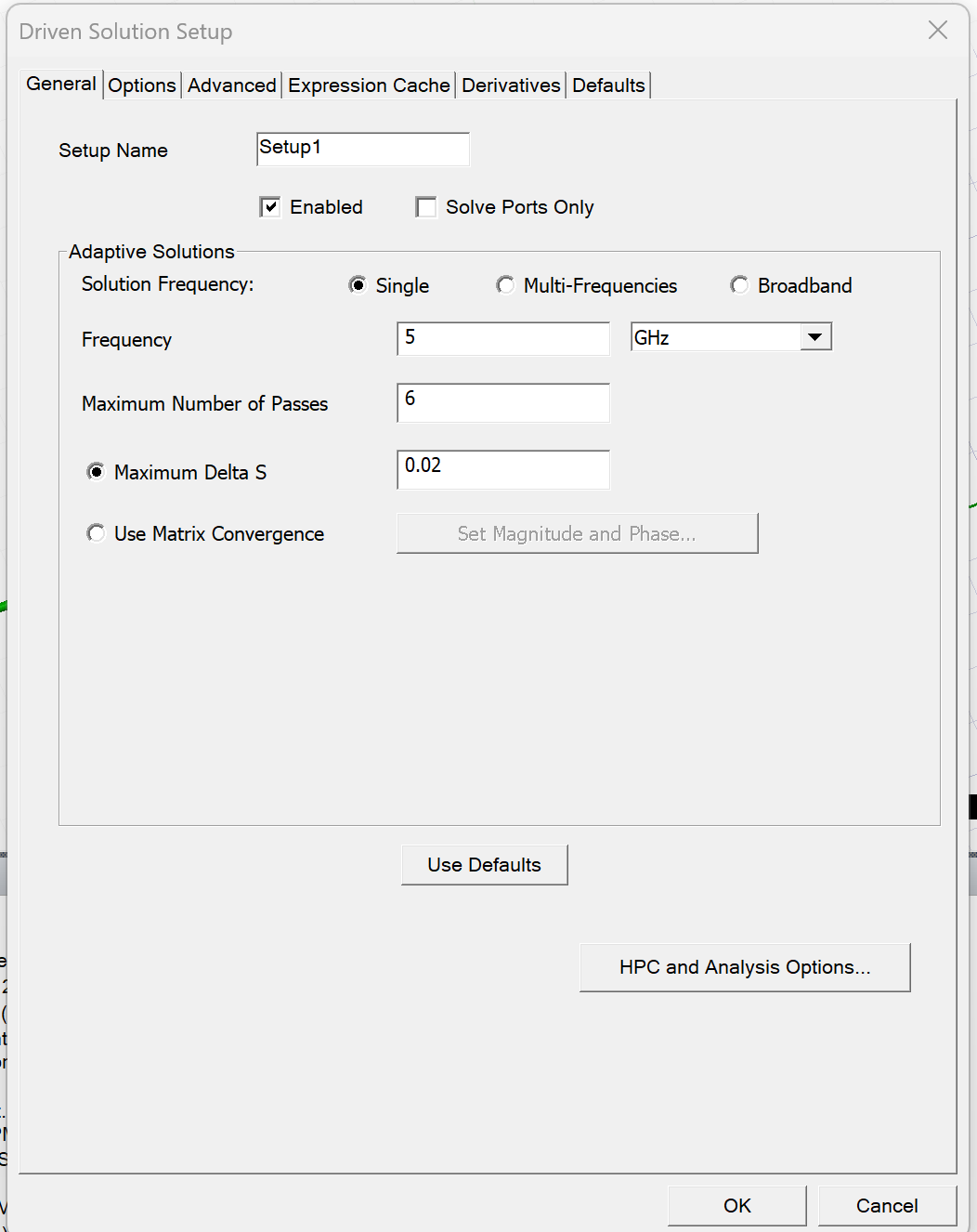

Please that the following error “Solution Setup” was corrected before running the simulation. (See screenshots attached)

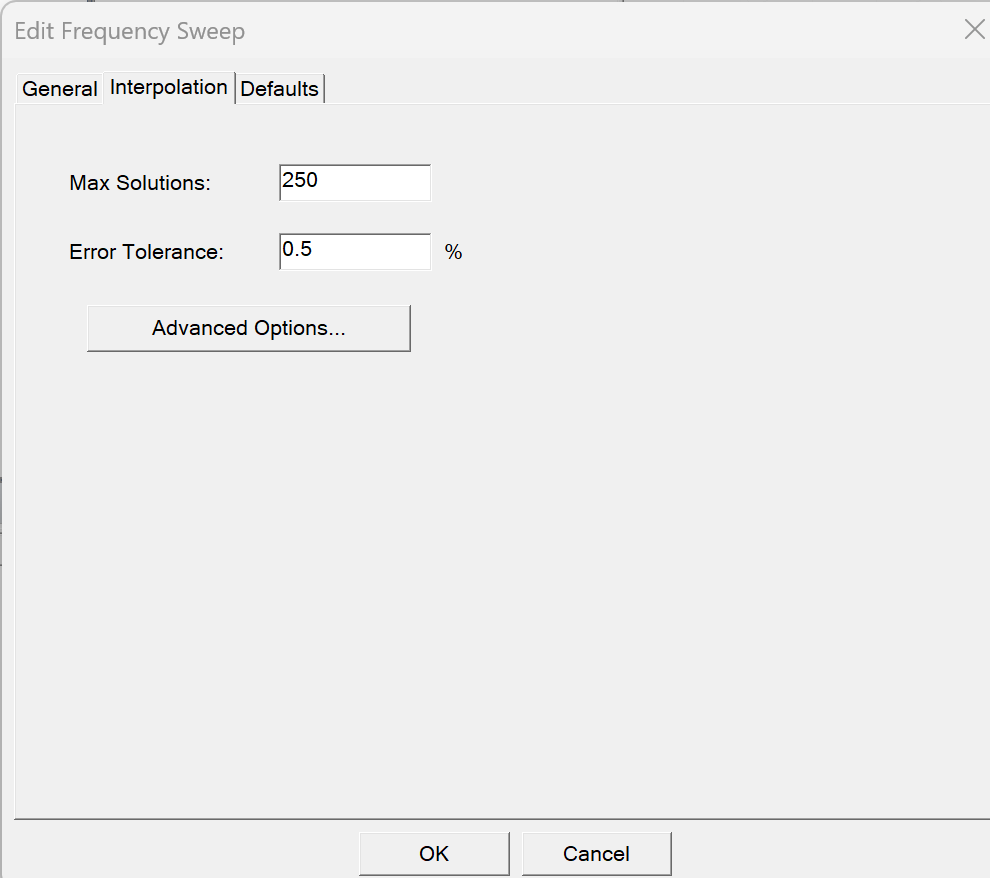

Please check the error tolerance of interpolating sweep in the Edit Frequency Sweep dialog box under Interpolation tab. You can relax it further to converge interpolating sweep. e.g. if it is 0.1% currently, you can increase it to 0.5% to relax the tolerance.
