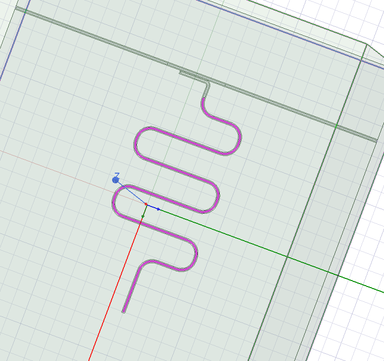

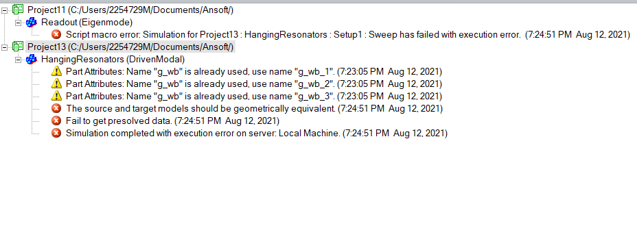

I am trying to import a mesh from an eigenmode solution into a drivenmodal solution. The design is a coplanar waveguide resonator coupled to a feedline. The method I am trying with the drivenmodal setup is HFSS->Analysis Setup->Add Solution Setup...->Advanced->Import Mesh. The current result of the mesh is shown below and the wanted mesh from the eigenmode solution is shown last. I have also added the error I retreive from analys is first below. Any help is much appreciated.

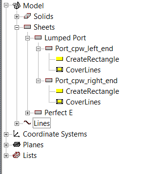

Thanks a lot for your response. The reason I am importing this mesh is that the eigenmode solution actually provides the desired mesh I want with the mesh being denser around the resonator as shown in the last picture. The second picture I believe is the adaptive meshing for the drivenmodal solution but does not provide a good mesh hence poor S-Parameter results. This is why I am trying to seed the mesh from eigenmode to drivenmodal unless there is another way to achieve the same goal. I think that the geometry error lies with the lumped ports on the drivenmodal solution not appearing on the eigenmode model as excitation ports cannot be rendered in eigenmode but I am still trying to figure out how to work around this.

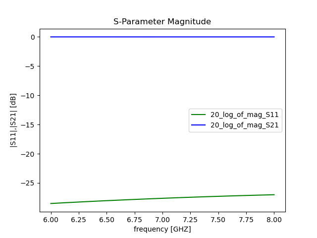

You have mentioned that the S-parameter result of driven modal is not as good as the eigen mode one. Please share the comparison plot of both.
Best regards.
August 25, 2021 at 2:54 pmnathmoses
SubscriberHi thanks again for your reply Yes I think I shall refer to the help document and explore with setting more strict convergence criteria.
I have attached the resonator highlighted and the S-Parameter results for the driven modal analysis. I am expecting a dip in magnitude at around 7.1GHz , as that is the resonant frequency of the resonator yet there is a flat line for the S21 and S11 parameter.
I am not necessarily comparing the S-parameter results between eigenmode and drivenmodal, I just wish to use the mesh from the eigenmode as it is focussed around the resonator and coupling component, not the feed line.
