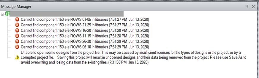

When a HFSS file (simulated and saved) is reopened the following pop up appears.
Correspondingly, the message manager window displays the following message.
Upon clicking ‘OK’ in the first pop-up, the following final pop-up appears.
The designs and the results are lost as a consequence.Â

Ansys EmployeeHi,Â
Please make sure you have .aedb and .aedteresult folders. If .aedb folder is not present in the project directory, the model will get corrupted and will be unable to open.
Another way to save the project with results is you can always save an archive file.Â

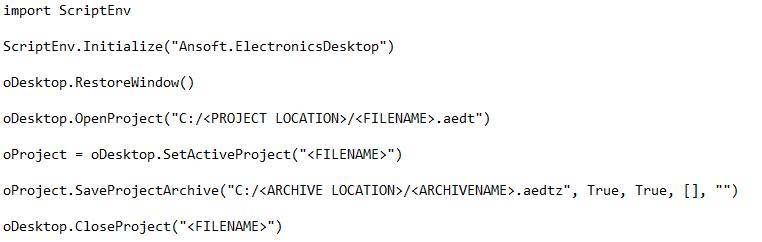

If you need to archive many projects, you could use scripting. A generic script for archiving is attached. You could add some additional Python code to parse through folders (e.g. import os) and automatically archive all the projects in a folder. You could add some exception handling for any projects that won't open. Any that did not open could be diagnosed and opened using alternative methods (such as removing the edb path reference in the project folder).
