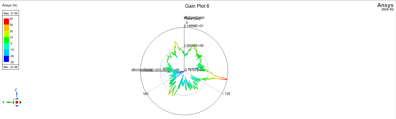

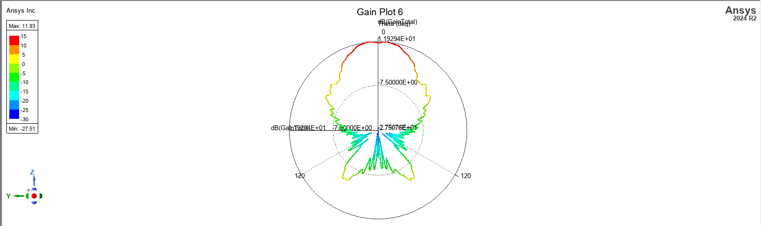

      When the radiation pattern of the feed horn (1.12 GHz) is analyzed using the HFSS-IE Hybrid Solver with the feed horn placed inside a box for FEA and two absorbing panels (Impedance Boundary) installed in front of it, the following result is obtained. However, when aluminum offset parabola dual reflectors are added, the feed horn's radiation pattern changes as shown. I would like to know the reason why the feed horn's radiation pattern changes, even though it should remain unchanged.
      Before adding reflectors :
      After adding reflectors :
      image.png</p>

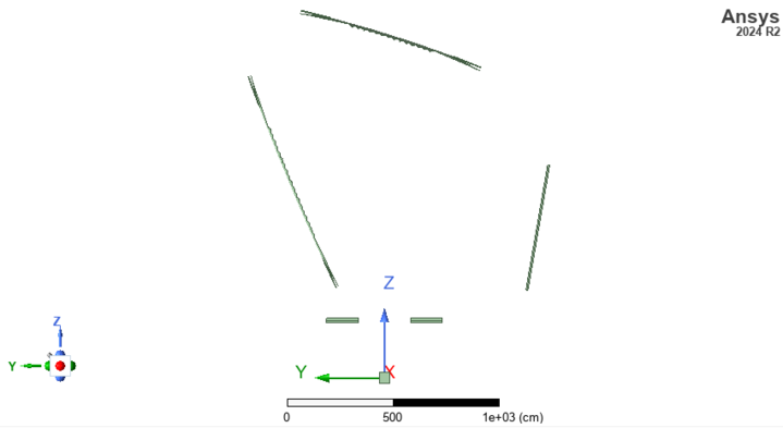

      Reflector Setup Information: Finite Conductivity Boundary,Hybrid Regions(IE Regions)
      • Material: Aluminum
      • DC Thickness: 10 mm
      • Surface Roughness: 0 (Groiss )
      • Z-axis Reflector Position: 1644.0583 cm from the origin along the Z-axis
      • Y-axis Reflector Position: -451.17 cm along the Y-axis and -922.24 cm along the Z-axis from the origin
      • Distance Between Reflectors (Center-to-Center): 1026.68 cm (38.32λ at 1.12 GHz)
      • Angle Between Reflectors: 26.06855°
      Adaptive Solution Settings:
      • Frequency: 1.12 GHz (Single Frequency)
      • Maximum Delta S: 0.05 (Convergence Criterion)
      • Maximum Number of Passes: 5
      • IE Solver Setting업로드한 이미지
      I would appreciate guidance on the following points:
      • What are the common factors that could cause a feed horn's radiation pattern to change upon the addition of offset parabola dual reflectors?
      • Are there specific aspects of the reflector design or placement that I should examine to understand this alteration?
      • Could the simulation parameters within HFSS-IE be contributing to this issue, and if so, which settings are most critical to review?
      Any insights or suggestions from those with experience in similar simulations or practical implementations would be highly valuable.

    • shkim
      Hi Praneeth,
      Thank you for your response and suggestions. Here are additional details regarding my setup:
      1. Vacuum box and feed horn definition:
       A vacuum box was defined around the feed horn.
       The feed horn is set up using the FEBI (Finite Element Boundary Integral) method.
      2. Absorbing boundaries:
       In front of the vacuum box, two walls simulating absorbers were placed. These absorbers effectively minimize unwanted reflections, and they are working well in the simulation.
       The absorbing walls are configured as an impedance boundary with resistance of 300 ohm and reflectivity of 0.01.
       The absorbing walls are part of a rectangular box, which is also set up using the FEBI method.
      3. Reflector system setup:
       Two reflectors were placed to simulate an offset Gregorian dual-reflector system.
       The feed horn was positioned at the focal point of the reflector system.
       The radiation from the feed horn first hits the small (sub) reflector, then reflects onto the larger main reflector.
       There was no returned signal detected on the feed horn, confirming that the absorber setup is functioning as expected.
      4. Next steps:
       I will try the example you suggested (HFSS > Antennas > Parabolic Dish or Gregorian Reflector) to compare results.
       If needed, I can send my model for further review to better understand the cause of the radiation pattern changes.
      Let me know if you need any additional details.
    • Praneeth
      Thank you for the reply.
      Please confirm whether you are assigning any hybrid region to the reflectors. If so, the radiation pattern would definitely change between the reflector and no reflector designs.
      Best regards,
      Praneeth.
