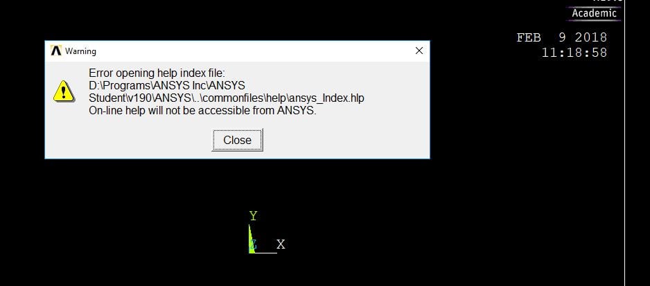

      Hello everyone,
      I just installed Ansys 19.0 and the installation process was successful. I can open Ansys modules normally and run analysis (performed a successful analysis in APDL). But when trying to access Ansys Help today, it doesn't open. The error message below shows up. What is the problem?
    • Vishal Ganore
      Hi Ren,
      We have a defect in our Student product's link to our help system at R19.0. Apologies for this inconvenience.
      Our development is trying to correct this issue asap. Meanwhile, you could go ahead with using 18.2.
      Vishal
