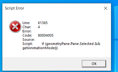

SubscriberMarch 8, 2021 at 12:49 pmANSYS_MMadore
Forum ModeratorArray Could you please open a Windows command prompt and run the command set without quotes and send the full output? Could you refer to this post to see if it may apply in your case? /forum/discussion/comment/92545#Comment_92545nPlease also try this, make sure all ANSYS applications are closed, then try registering the DLL's by starting a Command Prompt with run as administrator , and issuing the following commandsnregsvr32.exe ole32.dllnregsvr32.exe atl.dllnregsvr32.exe oleaut32.dllnregsvr32.exe scrrun.dllnregsvr32.exe jscript.dllnregsvr32.exe vbscript.dllnNovember 20, 2022 at 7:15 pmNovember 22, 2022 at 1:16 amMAHESH BALASURIYA
