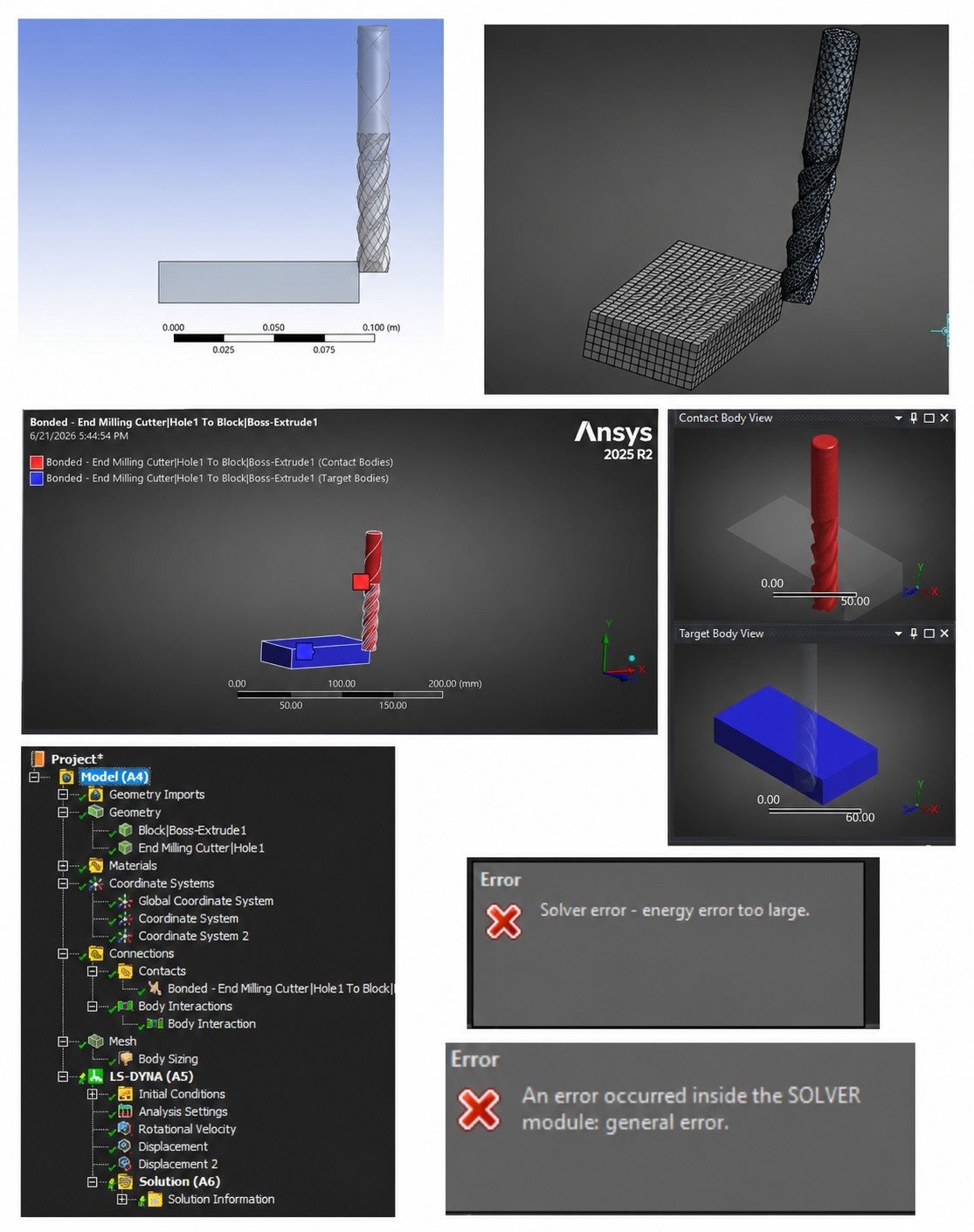

      I am currently learning LS-DYNA and trying to simulate an end milling operation with chip formation.
      I have modelled the milling cutter as a rigid body and the workpiece as a deformable body. However, I am facing difficulties in defining the correct contact interaction required for material removal. The simulation also terminates with errors such as "Energy error too large" and "General solver error."
      I have attached screenshots of my model setup, contact definition, and the solver errors.
      Could anyone please guide me on:
      • The recommended workflow for end milling simulations in LS-DYNA.
      • The correct contact definition for chip formation.
      • The essential Control Cards, Database Cards, and Keywords required for this type of simulation.
      • Any official tutorials or benchmark examples for metal cutting using LS-DYNA.
      Thank you for your time and guidance.

      I saw you have the contact between the cutter and work piece as "Bonded", which I think should be surface to surface type.
