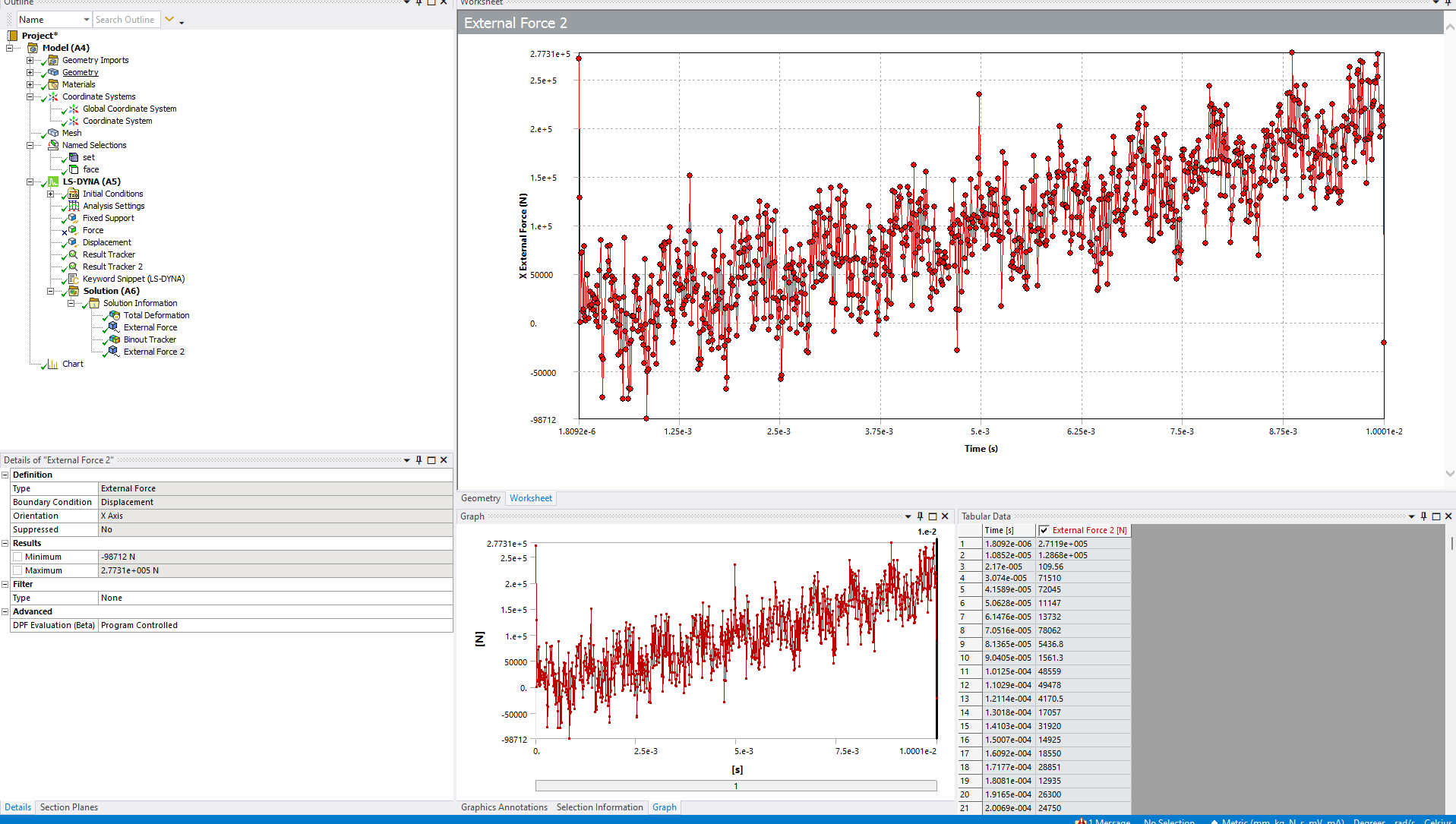

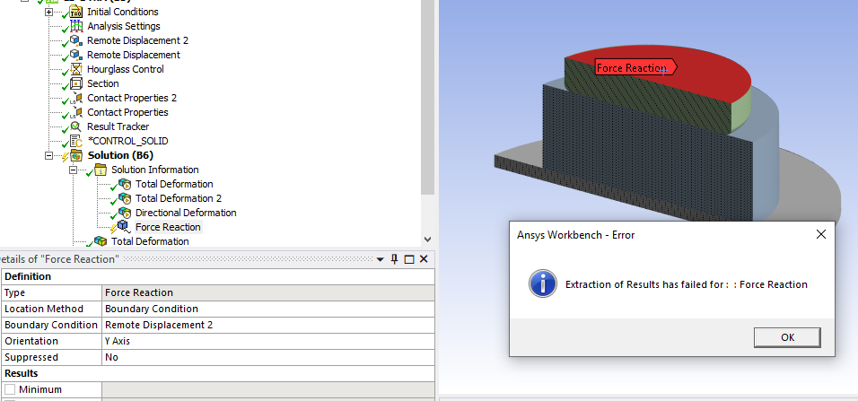

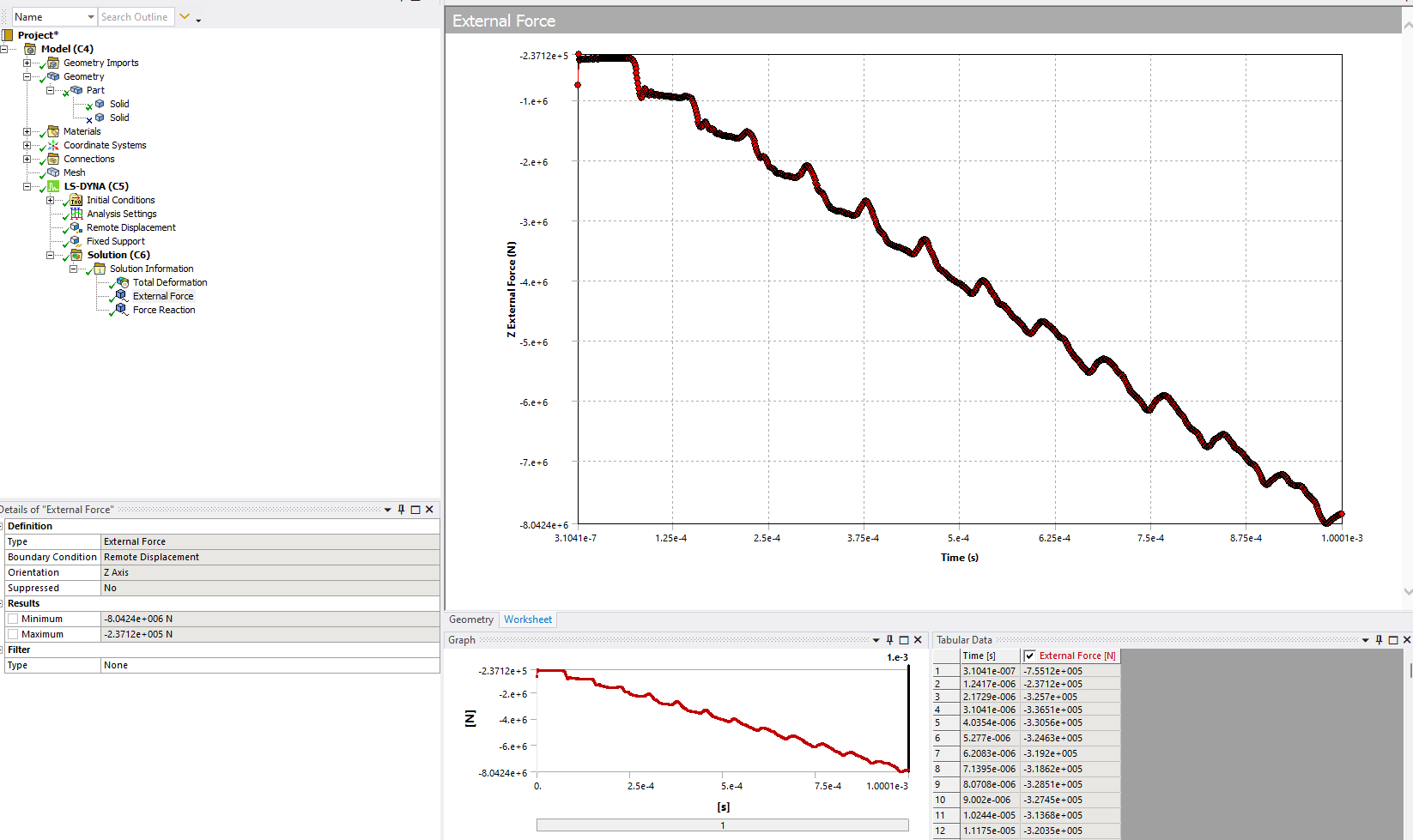

I use displacement for moving and body, the calculation is successful, if I use force, then I get a bunch of errors and the calculation does not go.
Is it possible to get force reaction in the results in LS-Dyna workbench? -

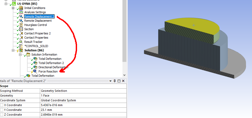

Ansys EmployeeHello Javat,
Reaction force can be used to get the equivalent force load to the applied displacement load. For this, go to the tree outline and drag the applied displacement down to the Solution object and it will add a Force Reaction item. Right-click on Solution and pick Evaluate all results. The force reaction values are listed in the details window.Regards,

javat33489
SubscriberI know it very well, thank you.
Please read the question carefully.
In LS-Dyna in WORKBENCH, you can't do that. That's why I wrote this post.
January 23, 2025 at 1:12 pm
Raman Babu

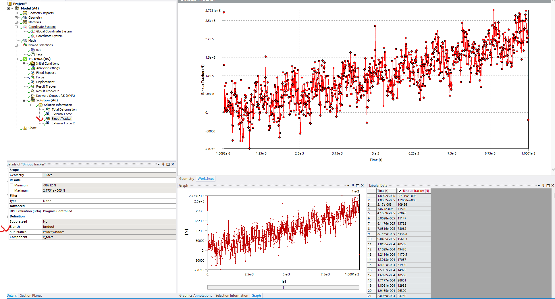

You can use the External Force option available under solution information to extract force reaction on displacement BCs. Please see the below snapshot for your reference.
You can also use Binout tracker option to insert bndout in the workbench and extract the reaction on displacement BCS. Please see the snapshot for your reference.
Please try it and let me know how it goes.

January 27, 2025 at 4:05 pm
javat33489
SubscriberThank you sir it works
