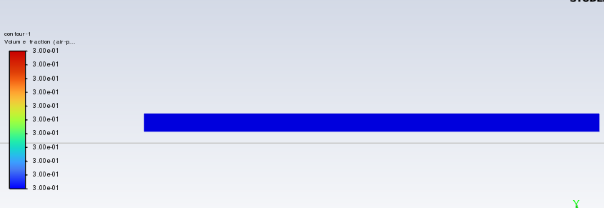

SubscriberI am trying to simulate a multiphase flow in a straight section of pipe. The end goal is to see the visual flow topology (volume fraction of air phase in water). The air volume fraction at the inlet is 1/3. I have used the transient solver and the mixture model but when I view the contour of the air volume fraction, it appears to be uniform (1/3) across the pipe. I expected it to have contours with regions in the pipe ranging from 0 (no air) to 1 as shown below:
Here is what I get below:
I'd really appreciate some help on this issue.

Ansys EmployeeHi,
Can you please give more information on the boundary condition you employed for the given problem?
Thank you
Saurabh

Esivue Eshilama
SubscriberInlet velocity: 4.5 m/s; Wall roughness height: 4.7e-4; Surface tension constant (water/air): 7.48e-2; Pipe diameter: 0.052m; Pipe length: 1.3m; air volume fraction:0.3333

Ansys EmployeeHi,
As the air volume fraction is 0.333, it is better to go for  Multiphase ---> Eulerian----> Multi-Fluid VOF model.
You can go through the theory guide: https://ansyshelp.ansys.com/account/secured?returnurl=/Views/Secured/corp/v222/en/flu_th/flu_th_sec_ifm.html
Also check this section of user guide: https://ansyshelp.ansys.com/account/secured?returnurl=/Views/Secured/corp/v222/en/flu_ug/flu_ug_sec_mphase_using_steps_eulerian.html%23flu_ug_sec_use_ifm
Please go through forum discussion: Simulating bubble formation in water container (ansys.com)

Rob
Forum ModeratorTo add, have a look at a Baker Chart to understand when (how) flow regimes are established. With a constant volume fraction on the inlet you may need a lot of pipe before anything interesting happens. You did turn on gravity?Â

SubscriberYes, I did turn on gravity. I'll try those and relate back to you.
