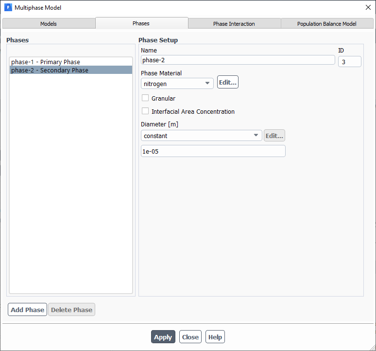

SubscriberI am using Multiphase---->Eulerian----->Multi-Fluid VOF model. I am able to model bubble formation, coalescence, breaking into smaller bubbles, and bursting at the top of the water surface. But I didn't find any option to set inlet bubble size. Is it possible in this model?
May 21, 2021 at 1:53 pmRob
Forum ModeratorNo, you can set the bubble size in the phase panel. You can also use population balance. However, as you want to see the bubbles growing etc multifluid VOF or VOF are the models to look at.
May 21, 2021 at 2:52 pmDeepak_296
SubscriberThanks Rob for this information. But I am unable to find that in the phase panel. If you can give me some details on how to set the initial bubble size in the phase panel, it would be very much helpful for me.
May 21, 2021 at 3:12 pmMay 22, 2021 at 4:33 pmDeepak_296
SubscriberI tried setting the initial bubble size, but it is giving the same result. Although it is of 1e-5 order, the diameter of the bubble forming first is approximately 1 cm. How is that possible? Am I missing something here?
May 24, 2021 at 8:46 amRob
Forum ModeratorThe bubbles size in the panel is for the Eulerian model. Depending on the flow field and boundary condition you can get anything from a dispersed flow to a stable free surface.

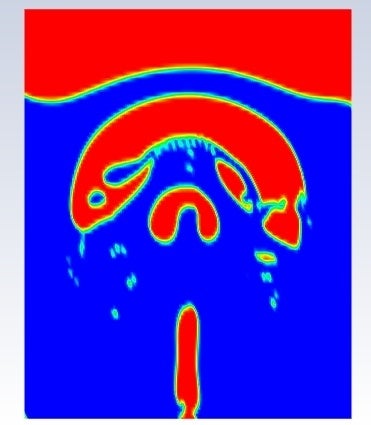

June 1, 2021 at 7:44 pmJune 2, 2021 at 10:33 amRob
Forum ModeratorThat looks pretty good: bubbles tend to deform depending on the velocity, viscosity and surface tension effects.
June 2, 2021 at 4:53 pmDeepak_296
SubscriberYes, bubble deformation will occur depending on the above-mentioned parameter. But the bubble is almost 50 mm in size as the total width of the domain is only 80 mm. How can I get smaller bubbles which are confirmed by the experiments? And how to get plume region?
