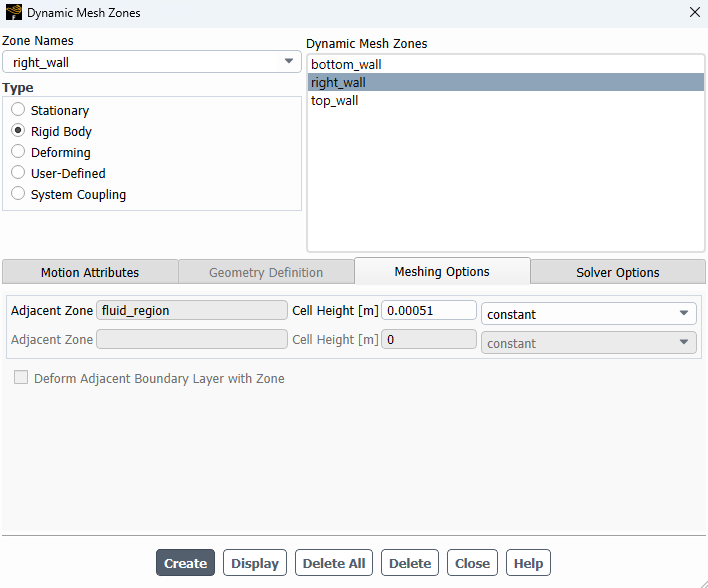

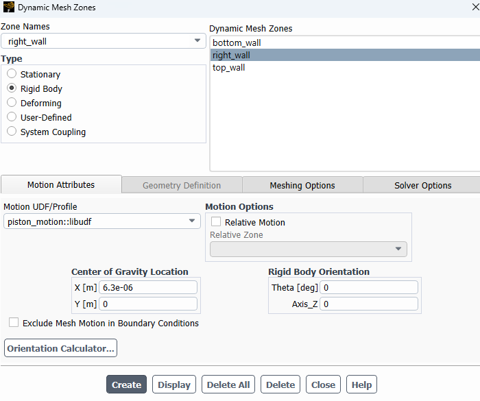

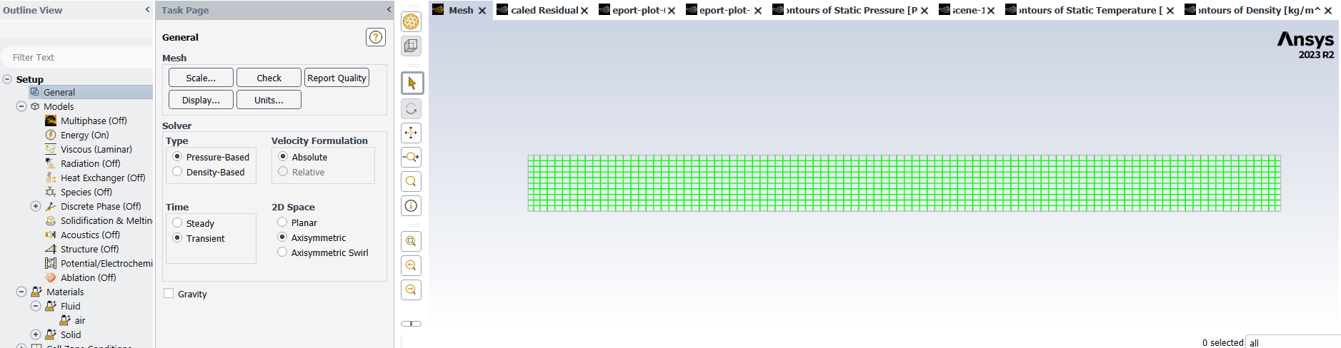

SubscriberI am simulating a 2D closed cavity with a moving wall (similar to a piston) using ANSYS Fluent (2023 R2) and dynamic mesh with layering. The mesh is structured (100 × 10 cells), cavity length 51 mm (and height 3.81 mm - axisymmetric, transient and pressure-based solver). The piston is the right wall, moved using DEFINE_CG_MOTION, while the fluid cell zone is deforming. Top, bottom, and left walls are stationary (I included top and bottom in the dynamic mesh zones as deforming instead of fluid_region, which seems to have worked correctly).

SubscriberYes, according to mesh metrics the mesh quality is really good.Â

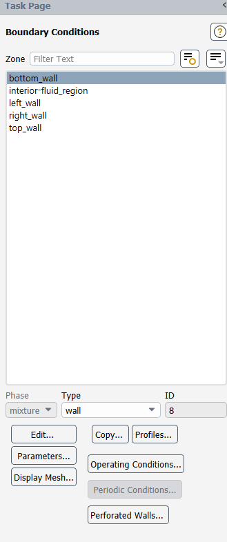

Forum ModeratorPlease can you post some images? Mesh, materials settings as a start.Â
February 25, 2026 at 2:42 pm
February 26, 2026 at 9:43 am
Rob
Forum ModeratorTry turning off the MDM and see what happens. When trouble shooting we turn things off until it works and turn things back on in a different order until it breaks. Then focus on whatever that was.Â
